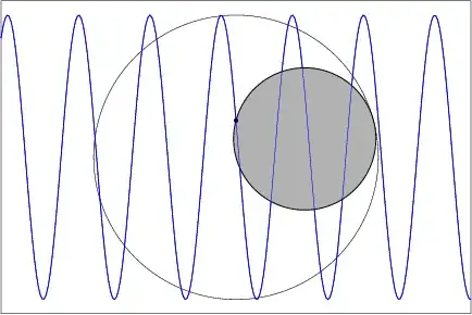

Here's an ideal mechanical device to draw a sine curve: When a disk $D$ of radius $r$ (shaded below) rolls without slipping inside a circle $C$ of radius $2r$, each point on the perimeter of $D$ traces a diameter of $C$. Place such an apparatus over a roll of paper whose lateral speed (here, left to right) is constant (possibly geared to the angular speed with which $D$ rolls inside $C$, in order to control the wavelength). The boundary point of $D$ lying on the diameter of $C$ perpendicular to the lateral motion of the paper traces a sine curve on the paper.
A rolling wheel traces a sine curve on a roll of paper

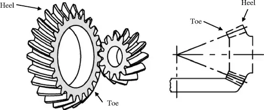

  1. Make a small cart that rolls in a straight line.
  2. To one of its wheels, attach a bevel gear (like the one below) which meshes with another whose axis is parallel to the motion of the cart, i.e. perpendicular to the front of the cart. enter image description here
  3. To any point of the second gear except its middle, hang a laser so that it points downwards, and can freely swing like a gondola of a Ferris wheel. If larger amplitude is needed, add a crank and affix the laser to freely hang from it.
  4. Slowly roll the cart over light-sensitive paper, ensuring that the laser doesn't pendulate.
The bevel gears convert horizontal motion into rotation perpendicular to direction of travel. The free-hanging laser extracts the second gear's horizontal component which is sinusoidal. The motion of the cart translates the paper uniformly relative to the cart to trace out the sine wave.
