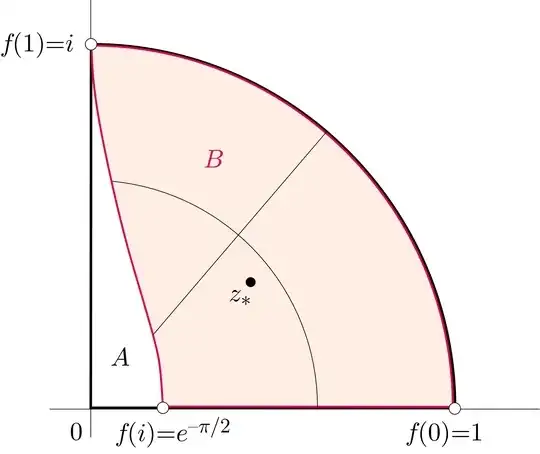

For $z\in{\mathbb C}$ we choose the following definition of $i^z\>$: $$i^z:=\exp\bigl(z\>{\rm Log}(i)\bigr)=e^{i\pi z/2}\ .$$ We then have to analyze the sequence $(z_n)_{n\geq0}$ defined by $$z_0:=1,\qquad z_{n+1}:=e^{i\pi z_n/2}\quad(n\geq0)\ .$$ The first terms of the sequence are $1$, $i$, $e^{-\pi/2}\doteq 0.207$, all in the set $A:=\overline\Omega$, where $$\Omega:=\{z=x+iy\in{\mathbb C}\>|\>|z|<1, \ x>0,\ y>0\}\ .$$ The well known properties of the exponential map show that the function $$f(z):=e^{i\pi z/2}=e^{-\pi y/2}\cdot e^{i\pi x/2}$$ maps $A$ bijectively onto the domain $B$ shaded red in the following figure, and it maps $\Omega$ onto the interior of $B$, which is a proper subset of $\Omega$. As $B\subset A$, by Brouwer's fixed point theorem $f\restriction A$ has at least one fixed point $z_*\in A$. Since no point of $\partial A$ stays fixed it follows that $z_*\in \Omega$.
The Riemann mapping theorem allows to conjugate $f\restriction\Omega$ with a map $g:\>D\to D$, the unit disk of the $w$-plane, that keeps $0$ fixed. Since $g(D)\subsetneq D$ Schwarz' Lemma then guarantees $|g(w)|<|w|$ for all $w\in \dot D$. This implies that there can be no other fixed point, and more: The sequence $(w_n)_{n\geq0}$ will converge to $0$ (the assumption $\inf_{n\geq0} |w_n|=:\rho>0$ would lead to a contradiction). We therefore can conclude that $\lim_{n\to\infty} z_n=z_*$. Note that $$\bigl|f'(z_*)\bigr|=\bigl|g'(0)\bigr|<1$$ shows that $z_*$ is indeed attractive. I computed the first $200$ points $z_n$ and obtained the estimate $z_*\doteq 0.438283 + 0.360592\> i$. At the fixed point one has $\bigl|f'(z_*)\bigr|\doteq0.89$. This reveals that the convergence is not particularly fast.
