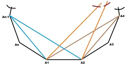

Consider a side $\mathrm{A_1A_2}$ of regular n-polygon. To get a triangle with only one side $A_1A_2$ common (As shown in figure-1 below)
Figure-1 (figure-1)
Join the vertices $A_1$ & $A_2$ to any of $(n-4)$ vertices i.e. $A_4, \ A_5,\ A_6, \ \ldots \ A_{n-1}$ to get triangles with only one side common. Thus there are $(n-4)$ different triangles with only one side $A_1A_2$ common. Similarly, there are $(n-4)$ different triangles with only one side $A_2A_3$ common & so on. Thus there are $(n-4)$ different triangles with each of $n$ sides common. Therefore, number of triangles $N_1$ having only one side common with that of the polygon $$N_1=\text{(No. of triangles corresponding to one side)}\text{(No. of sides)}=\color{blue}{(n-4)n}$$

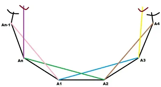

Now, join the alternate vertices $A_1$ & $A_3$ by a straight (blue) line to get a triangle $A_1A_2A_3$ with two sides $A_1A_2$ & $A_2A_3$ common. Similarly, join alternate vertices $A_2$ & $A_4$ to get another triangle $A_2A_3A_4$ with two sides $A_2A_3$ & $A_3A_4$ common & so on (as shown in above figure-2). Thus there are $n$ pairs of alternate & consecutive vertices to get $n$ different triangles with two sides common (Above fig-2 shows $n$ st. lines of different colors to join alternate & consecutive vertices). Therefore, number of triangles $N_2$ having two sides common with that of the polygon $$N_2=\color{blue}{n}$$ If $N_0$ is the number of triangles having no side common with that of the polygon then we have $$N=N_0+N_1+N_2$$ $$N_0=N-N_1-N_2$$ $$=\binom{n}{3}-(n-4)n-n$$ $$=\color{}{\frac{n(n-1)(n-2)}{6}-n^2+3n}$$ $$N_0=\color{red}{\frac{n(n-4)(n-5)}{6}}$$ The above formula $(N_0)$ is valid for polygon having $n$ no. of the sides such that $ \ \ \color{blue}{n\geq 6}$

    Can you elaborate a bit more on how you got *the number of triangle's having one side common with the polygon as $$N_1=(n-4)n$$* – Freelancer Nov 16 '15 at 05:18
    @Freelancer you have $n$ choice of sides. Assume you pick a side $AB$. Then, you have two less points to choose from for the third vertex. Also, the two sides that are on the right and left of $AB$ are not to be picked, for else the triangle would share two sides with the polygon. Thus, those are two less points to choose from, and you have $n-4$. Multiply the choices, and you are done. – Hasan Saad Sep 14 '16 at 08:33
