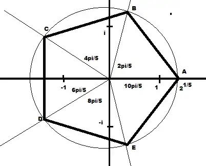

One way to attack this baby is to remember that the number of $n$-th complex roots of a number is always $n$, and that those $n$ roots form the vertices of an $n$-sided regular polygon on the Complex plane. So there are $3$ cube roots, forming a triangle, $4$ cube roots, forming a square, $5$ fifth roots, forming a pentagon, and so forth.
Int the above diagram, the pentagon is superimposed on the Complex plane. It has been broken broken up into five segments. The angle between each segment is $1/5$ that of a full circle. That is, each angle is $2\pi/5$. Each of the points, $A$ to $E$ is located by two numbers: One number is the distance from the centre of the figure. The other number is the angle that around the circle that it's located away from point $A$.
The angles are marked on the diagram. $A$ is $0$, (but it's marked on the diagram as $10\pi/5=2\pi$ because travelling $2\pi$ radians from any point on a circle will take you back to where you started).
Your angles are as follows:
$A. 0$
$B. 4\pi/5$
$C. 2\pi/5$
$D. 6\pi/5$
$E. 8\pi/5$
The number you also want to know the argument which is the Real number value of the length of each of those spikes from the centre to a point. That number is the Real value of $2^{1/5}$.
How do you arrange all this information is your final stretch. If we designate $z$ as your Complex root, $r$ as your argument (which is $2^{1/5}$ in each case) and $\theta$ for your angles, your general forms are:
$$z = r(\cos\theta + i\sin\theta)$$ and $$z = e^{i\theta}$$
(Why these are equivalent is another story.)
So, your five roots are:
$$A.\; 2^{\frac{1}{5}}e^{0i}=2^{\frac{1}{5}}$$ $$B.\; 2^{\frac{1}{5}}e^{2\pi i/5}$$ $$C.\; 2^{\frac{1}{5}}e^{4\pi i/5}$$ $$D.\; 2^{\frac{1}{5}}e^{6\pi i/5}$$ $$E.\; 2^{\frac{1}{5}}e^{8\pi i/5}$$

To address the OP directly, you can always add $2\pi$ to any angle without changing the value of $z$ just as you can go around a circle exactly once and end up where you started.
So, you need only show the solution for $\theta=0$ and $\theta=2\pi$ takes care of itself.
