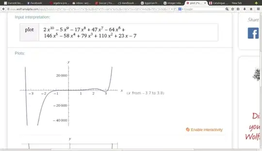

repeating degree ten, I like how the coefficients are small and begin with 2, I have not found any of these monic (beginning with $1$)
?  t = algdep(Pi,10)
%30 =   2*x^10 - 5*x^9 - 17*x^8 + 47*x^7 - 64*x^6 +
       146*x^5 - 58*x^4 + 79*x^3 + 110*x^2 + 23*x - 7
? polroots(t)
%31 = [-3.416642530754670637725737702 + 0.E-28*I,
        0.1631777144832237629669559802 + 0.E-28*I,
        2.659776825745310085407479343 + 0.E-28*I,
        3.141592653589793238462643332 + 0.E-28*I,
       -0.4285725799568636122958113382 - 0.1971284716837764691749795140*I,
       -0.4285725799568636122958113382 + 0.1971284716837764691749795140*I,
        0.6277749736794889930752953905 - 1.073388946479318133923381580*I,
        0.6277749736794889930752953905 + 1.073388946479318133923381580*I,
       -0.2231547252544536053351545286 - 1.460683263806221846450712438*I,
       -0.2231547252544536053351545286 + 1.460683263806221846450712438*I]~
pretty graph:
