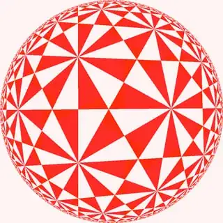

There are several models of hyperbolic space that are embedded in Euclidean space. For example, the following image depicts the Beltrami-Klein model of a hyperbolic plane:

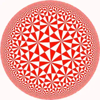

where geodesics are represented by straight lines. The following image, on the other hand, depicts the Poincare model of the same hyperbolic plane:
where geodesics are represented by segments of circles intersecting the boundary of the disk orthogonally. Both of these models capture the entire $n$-dimensional hyperbolic space in a disk (or more generally, a Euclidean $n$-ball).

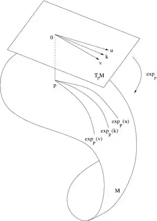

I was thinking about what hyperbolic space would "really look like" from the perspective of an observer within the space. What came to mind was the exponential map, which maps an element of the tangent space $\mathrm{T}_PM$ of a point $p$ on a manifold $M$ to another point on the manifold:

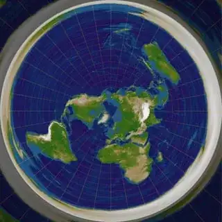

Intuitively, the exponential map follows the geodesic over the manifold that "departs" from the specified direction belonging to the tangent space. For example, the exponential map of the Earth as viewed from the north pole is the polar azimuthal equidistant projection in cartography:
This seems to be what elliptic space would "really look like" from the perspective of an observer within the space, since light reaches our eyes by traveling along geodesics.
This page and this page have demos. You may click around to get a feeling of what moving through an elliptic space would look like, though of course geodesics can go beyond the boundary of the disk in the demo by repeatedly wrapping around the sphere of the Earth.

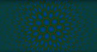

Edit 2: The last section of this video shows the azimuthal equidistant projection of a hyperbolic plane to be

    I think you're looking for #10 of this YouTube video. (I recommend watching the whole thing.) – Akiva Weinberger Aug 24 '15 at 18:36
  • @columbus8myhw What was the post? – user76284 Aug 25 '15 at 00:09
  • @columbus8myhw Thank you! The azimuthal equidistant projection of the hyperbolic plane is exactly what I was looking for. Do you know of any other examples of it online? – user76284 Aug 25 '15 at 00:10
  • He posted the program he used to compute the frames in the description. I haven't looked at it but it might be useful. If you want more info you can bug him in the comments, I guess. Or see if you can get anything useful on Google. – Akiva Weinberger Aug 25 '15 at 00:18

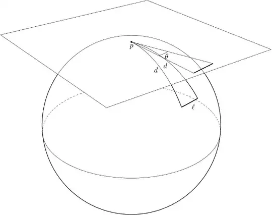

One common way to visualize the "intrinsic appearance" of a simply-connected universe of constant curvature $\pm 1$ is to give the angular size of an object modeled as a geodesic arc of (sufficiently small) length $\ell$ placed at distance $d$ from one's eye. (I didn't try to run the linked applets, and am not sure if either implements this strategy.)
On a sphere of unit curvature, a circle of geodesic radius $d$ has circumference $2\pi \sin d$; an object of length $\ell$ (placed "orthogonal to the line of sight") therefore subtends an angle $\theta \approx \ell/\sin d$.
The angle subtended by an object on a sphere
Playing the same game in the hyperbolic plane, a circle of geodesic radius $d$ has circumference $2\pi \sinh d$; an object of length $\ell$ (placed orthogonal to the line of sight) therefore subtends an angle $\theta \approx \ell/\sinh d$. As in mercio's comment, this angle decreases exponentially with $d$.

The Beltrami-Klein model is an accurate depiction of what it would look like in hyperbolic space. To be a bit more precise, if you live in 3-dimensional hyperbolic space $\mathbb{H}^3$, and if $P \subset \mathbb{H}^3$ is a 2-dimensional hyperbolic plane tiled in red and white triangles with angles $\pi/2,\pi/3,\pi/7$ as in the picture shown in the question, and if your eye is situated at a point $Q$ a certain distance from $P$, then what you would see is exactly that picture.
The intuitive reason for this is that geodesics are straight lines, and that is how they appear to your eye.
In a bit more detail, one can prove analytically that that if you take the straight line projection of a geodesic in $X$ onto the unit tangent sphere $T^1_Q (\mathbb{H}^3)$ of $\mathbb{H}^3$ at the point $Q$, then the result is a great circle segment in $T^1_Q (\mathbb{H}^3)$.
One interesting feature of this fact is that from $Q$ one can "see" the circle at infinity of $P$, just as the picture shows.
