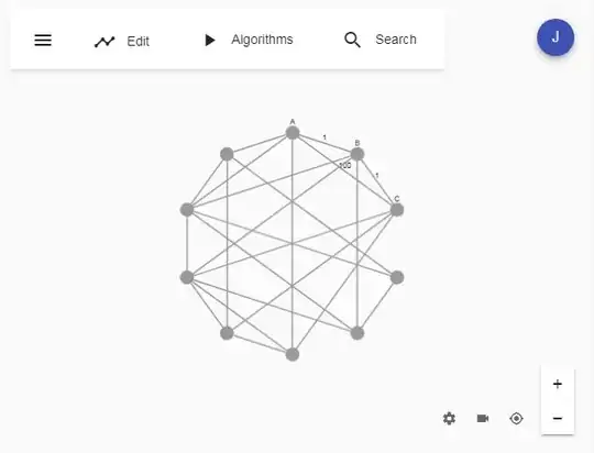

I've created a simple web application called Graphy. It's basing on a great library Cytoscape.js.
Features:
  • Importing graphs from GraphML, JSON Graph Format or JSON format used by Cytoscape.js
  • Exporting graphs to GraphML, JSON format used by Cytoscape.js and image (PNG and JPG)
  • Computing and visualization of basic algorithms (BFS, DFS, Dijkstra's algorithm, Kruskal's algorithm, Karger–Stein algorithm)
  • Edit Mode - adding vertices by clicking on workspace and adding edges by dragging (or by selecting an appropriate option from a context menu)
  • Grouping vertices
  • Changing style of nodes and edges (color, shape, thickness of edge, line style, node size)
  • Bending edges
  • Shortcuts support
  • Displaying the last action with possibility to undo
  • Copying, cutting, pasting of nodes and edges
  • Support for mobile and touch devices
The application is still in a development state – any suggestions and feedback are welcomed!
Graphy screenshot

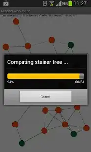

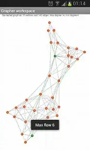

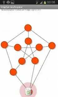

We wrote an Android app called Grapher for testing algorithms and exporting to tikz.
Screenshot is available on Grapher · GitHub, here are some screenshots:
deletemaxflowsteiner tree
