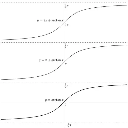

Edit: The arctangent function (also known as "the principal branch of arctan"), shown bold in the graph below, is single-valued. The tangent function, however, is periodic with period $\pi$, so there are infinitely many branches of inverse tangent, any two differing by an integer multiple of $\pi$. For every integer $n$, we have $$ x = \arctan(\tan x) + n\pi\quad\text{for $(n - \tfrac{1}{2})\pi < x < (n + \tfrac{1}{2})\pi$.} $$
Branches of arctan

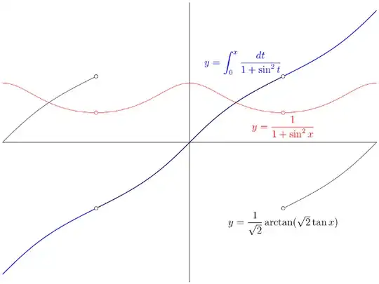

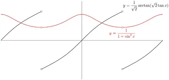

Consider the functions $$ f(x) = \frac{1}{\sqrt{2}} \arctan(\sqrt{2} \tan x),\qquad F(x) = \int_{0}^{x} \frac{dt}{1 + \sin^{2} t}. $$ The definite integral of g These functions have the same derivative $g$ for all real $x$ unless $x = (n + \frac{1}{2})\pi$ for some integer $n$; for these $x$, the value $f(x)$ is undefined, because $\tan(n + \frac{1}{2})\pi$ is undefined. Call these points poles of the tangent function.
As $x$ runs over the period interval $(n - \frac{1}{2})\pi < x < (n + \frac{1}{2})\pi$ between two poles of the tangent function, $\sqrt{2}\tan x$ runs once over the entire real line, so $\arctan(\sqrt{2}\tan x)$ runs once over the interval $(-\frac{1}{2}\pi, \frac{1}{2}\pi)$. The graph of $f$ consists of "repeated units", with a "jump" at each point $(n + \frac{1}{2})\pi$; the function $f$ "forgets" how many poles of tan lie between $0$ and $x$.
By contrast, the graph of $F$ "remembers" how many poles lie between $0$ and $x$. When $x$ crosses a pole of tan, $\sqrt{2}\tan x$ "jumps" from being "near $+\infty$" to being "near $-\infty$". Because area under the graph of $g$ accumulates continuously, the value of $F$ "continues" using the "next-highest" branch of arctan. Loosely, instead of "returning to $-\infty$ and re-using the same branch of arctan" (as $f$ does), $F$ continues by "following a dashed line from right to left" and starting on the next branch of arctan.
That is how $f$ and $F$ manage to have the same derivative (except at the poles of tan, where $f$ is undefined), but $f$ is periodic while $F$ extends continuously over the poles.
In the extended real numbers $[-\infty, \infty]$, in fact, arctan has a continuous extension, defined by $$ \arctan(\pm\infty) = \lim_{x \to \pm\infty} \arctan x = \pm\tfrac{1}{2}\pi. $$ This isn't much help with $f$, because now $f$ gets two values at each pole of tan, namely $\pm \frac{\pi}{2\sqrt{2}}$, but it does dictate why each time $x$ crosses a pole of tan, $F$ "climbs" to the next branch of arctan, and it shows why $F$ is continuous at the poles of tan.

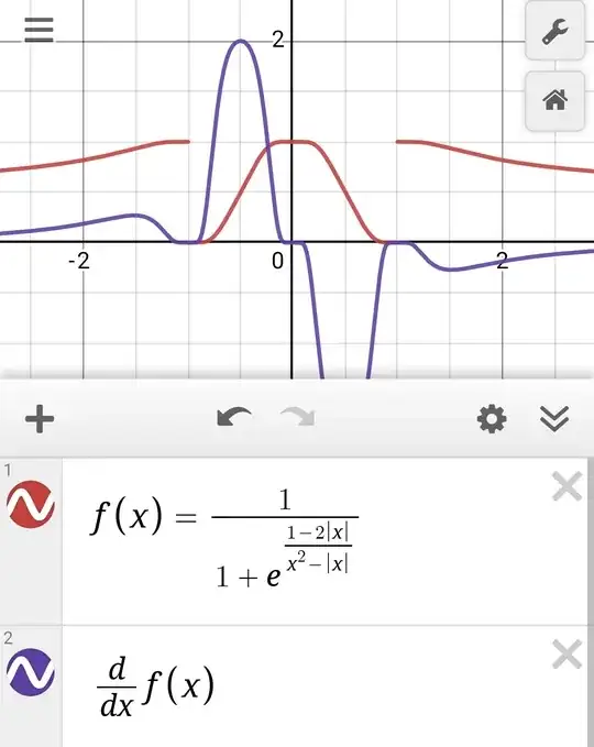

I believe an example of a discontinuous function with continuous derivative could be: $$f(x)=\frac{1}{1+\exp\left(\frac{1-2|x|}{x^2-|x|}\right)}$$ which is discontinuous at $x=\{-1;\ 0;\ 1\}$ but becomes flat from the left and the right so the derivative $f'(x)$ equal zero at both sides, so is continuous there.
You could check them in Desmos: desmos plot
Added later
After this question I realized my previous answer need to be corrected, since the function $f(x)$ is undefined at $x=\{-1,\ 0,\ 1\}$. A better example could be defining the function piecewise as:
$$g(x)=\begin{cases} 1,\quad x=0,\\ 0,\quad x=-1 \vee x=1, \\ \frac{1}{1+\exp\left(\frac{1-2|x|}{x^2-|x|}\right)},\ \text{otherwise}\end{cases}$$
Since at the piecewise points the function $g(x)$ is a constant, the derivative is zero there, matching the values of $g'(x)$ from the left and from the right at these points, same as the examples of the Wikipedia page for flat functions.
Important added later!
THE PREVIOUS ANSWER IS WORNG!, if the function is discontinuous at a point, the derivative is not defined so my answer is ill defined: even if I fixed the undefined points on the primitive function, where there are "jumps" the derivative will have there undefined points. Maybe if weak derivatives meaning is used instead it could fit, but I don't really know.
