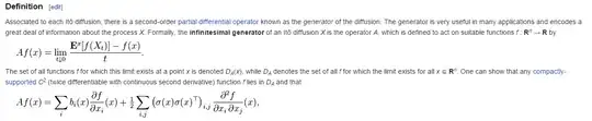

Suppose one has the an Ito process of the form:
$$dX_t = b(X_t)dt + \sigma(X_t)dW_t$$
The following is an excerpt from wikipedia
My question is on how to derive this operator? It looks very similar to what you get when using Ito's Lemma. So I start with applying Ito's Lemma with f to get:
$$df = \frac{\partial f}{\partial t}dt + \sum_i\frac{\partial f}{\partial x_i}dx_i + \frac{1}{2}\sum_{i,j}\frac{\partial^2 f}{\partial x_ix_j}[dx_i,dx_j]$$
Which then becomes:
$$df = \left[ \frac{\partial f}{\partial t}dt + \sum_i b_i(X_t)\frac{\partial f}{\partial x_i}dt + \frac{1}{2}\sum_{i,j}(\sigma\sigma^T)_{i,j}\frac{\partial^2 f}{\partial x_i \partial x_j} \right]dt + \sum_i \sigma_i(X_t) \frac{\partial f}{\partial x_i}dW_t$$
Hopefully I got that correct. What I'm unsure about is how to proceed in order to compute $Af(x)$. I would think the next step is to integrate $df$, but it's not clear to me what happens after (I know these infinitesimal generators are rooted in semigroup theory, but I have very little experience in that).
