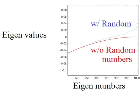

Numerical solution reveals that the eigen values around the maximum eigenvalue have the largest deviation from the case without random numbers ($R_i=0$). For example, the following figure shows eigen values with and without having the random numbers for m=0.1. But how we can solve the problem analytically? (Maybe by using central limit theorem)

  • Thanks, does this explain why the eigen-values around the maximum value would perturb more than the other values (Figure above)? – Roy Jul 04 '15 at 17:52
    I suspect that is because 1) the "density" of eigenvalues is larger for eigenvalues closer to $0$, so for second-order correction of eigenvalues close to the greatest there are many summands with low denominators and, thus, large value, 2) for eigenvalues close to the greatest one, the summands mostly have the same sign. – Budenn Jul 04 '15 at 18:01
