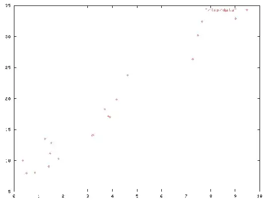

Scientific calculators all have a "linear regression" feature, where you can put in a bunch of data and the calculator will tell you the parameters of the straight line that forms the best fit to the data. For example, suppose you have a bunch of data that looks like this:
linear regression data

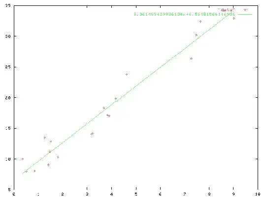

Linear regression will calculate that the data are approximated by the line $3.06148942993613\cdot x + 6.56481566146906$ better than by any other line.
the same linear regression data with plotted linear approximation
