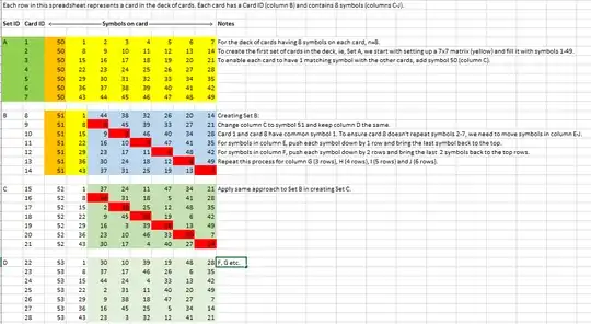

in AutoIt:
$r=1
$n=7
ConsoleWrite("Card" & $r & "=")
for $i= 1 to $n+1
   ConsoleWrite(" " & $i )
Next
ConsoleWrite(@CRLF)
for $j=1 to $n
   $r=$r+1
   ConsoleWrite(" 1")
   for $k=1 to $n
      ConsoleWrite(" " & $n + $n *($j-1) + $k+1 )
   Next
   ConsoleWrite(@crlf)
Next
for  $i= 1 to $n
   for $j=1 to $n
   $r=$r+1
      ConsoleWrite(" " & $i+1 & " ")
   for $k=1 to $n
   ConsoleWrite($n + 2 + $n* ($k-1)  + mod(($i-1) *($k-1) +$j-1, $n) & " ")
      Next
      ConsoleWrite(@crlf)
   Next
Next
Result:
Card1= 1 2 3 4 5 6 7 8
Card2= 1 9 10 11 12 13 14 15
Card3= 1 16 17 18 19 20 21 22
Card4= 1 23 24 25 26 27 28 29
Card5= 1 30 31 32 33 34 35 36
Card6= 1 37 38 39 40 41 42 43
Card7= 1 44 45 46 47 48 49 50
Card8= 1 51 52 53 54 55 56 57
Card9= 2 9 16 23 30 37 44 51
Card10= 2 10 17 24 31 38 45 52
Card11= 2 11 18 25 32 39 46 53
Card12= 2 12 19 26 33 40 47 54
Card13= 2 13 20 27 34 41 48 55
Card14= 2 14 21 28 35 42 49 56
Card15= 2 15 22 29 36 43 50 57
Card16= 3 9 17 25 33 41 49 57
Card17= 3 10 18 26 34 42 50 51
Card18= 3 11 19 27 35 43 44 52
Card19= 3 12 20 28 36 37 45 53
Card20= 3 13 21 29 30 38 46 54
Card21= 3 14 22 23 31 39 47 55
Card22= 3 15 16 24 32 40 48 56
Card23= 4 9 18 27 36 38 47 56
Card24= 4 10 19 28 30 39 48 57
Card25= 4 11 20 29 31 40 49 51
Card26= 4 12 21 23 32 41 50 52
Card27= 4 13 22 24 33 42 44 53
Card28= 4 14 16 25 34 43 45 54
Card29= 4 15 17 26 35 37 46 55
Card30= 5 9 19 29 32 42 45 55
Card31= 5 10 20 23 33 43 46 56
Card32= 5 11 21 24 34 37 47 57
Card33= 5 12 22 25 35 38 48 51
Card34= 5 13 16 26 36 39 49 52
Card35= 5 14 17 27 30 40 50 53
Card36= 5 15 18 28 31 41 44 54
Card37= 6 9 20 24 35 39 50 54
Card38= 6 10 21 25 36 40 44 55
Card39= 6 11 22 26 30 41 45 56
Card40= 6 12 16 27 31 42 46 57
Card41= 6 13 17 28 32 43 47 51
Card42= 6 14 18 29 33 37 48 52
Card43= 6 15 19 23 34 38 49 53
Card44= 7 9 21 26 31 43 48 53
Card45= 7 10 22 27 32 37 49 54
Card46= 7 11 16 28 33 38 50 55
Card47= 7 12 17 29 34 39 44 56
Card48= 7 13 18 23 35 40 45 57
Card49= 7 14 19 24 36 41 46 51
Card50= 7 15 20 25 30 42 47 52
Card51= 8 9 22 28 34 40 46 52
Card52= 8 10 16 29 35 41 47 53
Card53= 8 11 17 23 36 42 48 54
Card54= 8 12 18 24 30 43 49 55
Card55= 8 13 19 25 31 37 50 56
Card56= 8 14 20 26 32 38 44 57
Card57= 8 15 21 27 33 39 45 51
Uwe

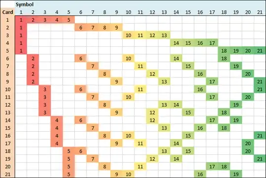

Dobble set for 5 symbols . Note that in cards 10 to 21, some of the indices cycle down whilst others cycle up. It was not possible to create a set if all the indices cycled in the same direction . I am still working on the Dobble set for 7 symbols .
Card 1 : 1, 2, 3, 4, 5
Card 2 : 1, 6, 7, 8, 9
Card 3 : 1, 10, 11, 12, 13
Card 4 : 1, 14, 15, 16, 17
Card 5 : 1, 18, 19, 20, 21
Card 6 : 2, 6, 10, 14, 18
Card 7 : 2, 7, 11, 15, 19
Card 8 : 2, 8, 12, 16, 20
Card 9 : 2, 9, 13, 17, 21
Card 10 : 3, 6, 11, 16, 21
Card 11 : 3, 7, 10, 17, 20
Card 12 : 3, 8, 13, 14, 19
Card 13 : 3, 9, 12, 15, 18
Card 14 : 4, 6, 12, 17, 19
Card 15 : 4, 7, 13, 16, 18
Card 16 : 4, 8, 10, 15, 21
Card 17 : 4, 9, 11, 14, 20
Card 18 : 5, 6, 13, 15, 20
Card 19 : 5, 7, 12, 14, 21
Card 20 : 5, 8, 11, 17, 18
Card 21 : 5, 9, 10, 16, 19
Below is a visualization of the pattern when there are 5 symbols per card from a set of 21 symbols and 21 cards.
Pattern visualization for 5 symbols per card
Ben
  • 103

Yesterday, I played the card game "Spot It" with my family and was facinated by the maths behind it. After working with my wife for a couple hours, we discovered the method to generate the cards. The method is now illustated using $8$ symbols per card.
Creating $49$ ($= 7$ sets of $7$) required cards:
Creating another set of $7$ using the matrix transpose:
the $57$th card:
The above method of construction can deal any number of symbols on the cards. It also shows that the maximum number of cards that meet the rules of the game is $57$, i.e. the same as the number of different symbols.
The general formula for the maximum number of cards with n symbols on each card satisfying the rules of the game is $(n-1)^2 + n$.

  • Now try your method on $n=7$, so there are 43 cards, 43 different symbols (each repeated 7 times through the deck). You will run into difficulties. ;) – PM 2Ring Dec 26 '20 at 11:27
  • Thanks. I have used the same method outlined in the post to create 43 cards satisfying the Spot It rules. I will put the solution up in another Answer. – user866942 Dec 26 '20 at 22:45
  • You can just add it to this answer. Please post is as plain text, so we can easily check it. – PM 2Ring Dec 27 '20 at 06:01

  • The OP sevanstephan posted a complete n=5 deck of 21 cards. As other answers on this page mentioned, it's straightforward to create a maximal deck for prime n, and not too hard if n is a prime power (but the mathematics requires finite field arithmetic, which is a little tricky when n is a prime power rather than a prime). I have some info about possible deck parameters here, plus a collection of Python programs that use various strategies to build decks, or at least attempt to build decks. ;) – PM 2Ring Jan 03 '21 at 20:14
