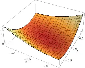

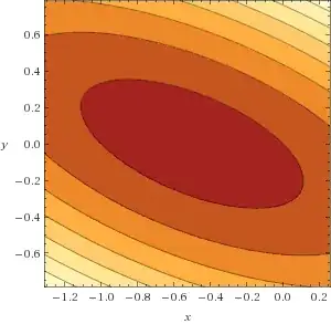

For example, if $\delta>0$ we get concentric ellipses, like in this example - the plots are taken from WolframAlpha:
Paraboloid
concentric ellipses

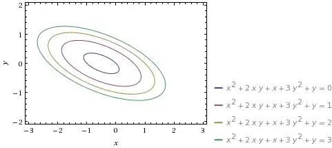

And a different plot:
Family of ellipses

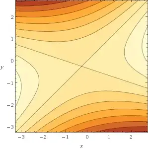

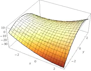

If $\delta>0$, we get a family of hyperbolas. WolframAlpha:
Hyperboloid
Hyperbolas as the level sets

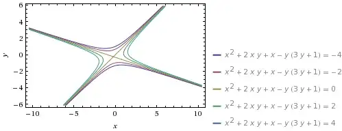

Family of hyperbolas
In the first case, the function $F$ has minimum at the center of each of the ellipse. In the second case there is a saddle point. In both cases, the center fulfills $$\frac{\partial F}{\partial x}= \frac{\partial F}{\partial y} =0$$ which leads to the system of equations \begin{align*} ax + by +d&= 0\\ bx + cy +e&= 0 \end{align*} which is precisely the linear system described above.
