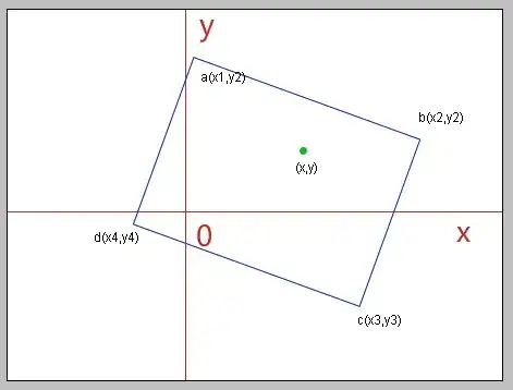

I have two dimensional Cartesian system and I need to check if certain point is within the geometry formed by four other points. I have few thousands different geometries all with different points to check. So I'm writing a program for it.
HERE is a solution method I started with and it works if the data points are always given in same order: A(x,y) B(x,y) C(x,y) and D(x,y) with the point P(x,y). (But it's not)
Cartesian Coordinates: (Image taken from above link)
My points are randomly given, so when connecting between the dots they might go to "opposite" corner so the drawing wouldn't be box exactly.
Case 1: A(x,y) B(x,y) C(x,y) D(x,y) with the point P(x,y).
Case 2: C(x,y) A(x,y) D(x,y) B(x,y) with the point P(x,y).
Case 3: D(x,y) B(x,y) A(x,y) C(x,y) with the point P(x,y).
Case 4: B(x,y) D(x,y) A(x,y) C(x,y) with the point P(x,y).
So it's impossible to write a program with earlier mentioned method. I've been looking around and I can't seem to find a method that doesn't care in which order it gets the coordinates of the geometry.
Thanks.

  • You are going to have a problem if your shape is concave ("arrowhead" or "dart") because there may be more than one way to draw a quadrilateral with those vertices. Consider A(0,0), B(0,5), C(3,3), D(1,3). – tomi May 07 '15 at 22:59
  • All of my data would make a some kind of a "box" as it's a generated data from a camera detecting that kind of shape. But for some unresolvable reason it doesn't mark the corners in same order. So I shouldn't get an arrowhead or a dart. – Bjartmar May 08 '15 at 09:52
  • If the 4 pts always form a rectangle as in the diagram then you can use the "dot product" to find lines that form a right-angle. E.g. Focus on pt A. If $AD\cdot AC=0$ then A's neighboring points are C,D and the rectangle is ACBD. If not 0, next if $AD\cdot AB=0$ then A's neighboring points are B,D and the rectangle is ABCD. If that's not 0 either, if $AC\cdot AB=0$ then A's neighboring points are B,C and the rectangle is ABDC. Exactly 1 of these 3 results must be 0. Once you find this, use the method you refer to to test P. Dot Product defn: $AD\cdot AC=(x_4-x_1)(x_3-x_1)+(y_4-y_1)(y_3-y_1)$. – Mick A May 08 '15 at 14:28
  • Thanks for the comment but unfortunately I do not always have right-angles. – Bjartmar May 08 '15 at 15:32
  • So what we know is that the 4 points form a convex quadrilateral? – Mick A May 08 '15 at 18:58
  • Yes, that's true. But I know that non of the angles, when the correct neighbours have been found, are more than 180°... if that could help. – Bjartmar May 08 '15 at 19:16
Consider point $A$. We need to find which two of the three points $B,C,D$ are its neighbours in the quadrilateral. So we consider the three line segments (or we can consider them as 2-dimensional vectors): $AB,AC,AD$. If $A's$ neighbours are $B,C$, say, then $\angle BAC$ will be greater than both $\angle BAD$ and $\angle CAD$, and therefore their cosines will have the opposite relationship. So we look for the angle with the small cosine.
So calculate:
\begin{eqnarray*} \cos(\angle BAC) &=& \dfrac{AB\cdot AC}{\|AB\|\|AC\|} \\ \cos(\angle BAD) &=& \dfrac{AB\cdot AD}{\|AB\|\|AD\|} \\ \cos(\angle CAD) &=& \dfrac{AC\cdot AD}{\|AC\|\|AD\|}. \end{eqnarray*}
Whichever is the least of these determines the two neighbouring points of $A$.
You can then use the method from the other question you refer to to check for point $P$.
Example: $A=(-2,1),\quad B=(2,6),\quad C=(5,2),\quad D=(1,-4)$.
\begin{eqnarray*} AB &=& (2-(-2))\;\mathbf{i} + (6-1)\;\mathbf{j} = 4\mathbf{i} + 5\mathbf{j} \\ AC &=& (5-(-2))\;\mathbf{i} + (2-1)\;\mathbf{j} = 7\mathbf{i} + \mathbf{j} \\ AD &=& (1-(-2))\;\mathbf{i} + (-4-1)\;\mathbf{j} = 3\mathbf{i} - 5\mathbf{j} \\ && \\ \|AB\| &=& \sqrt{4^2+5^2} = \sqrt{41} \\ \|AC\| &=& \sqrt{7^2+1^2} = \sqrt{50} \\ \|AD\| &=& \sqrt{3^2+5^2} = \sqrt{34} \\ && \\ AB\cdot AC &=& 4\times 7 + 5\times 1 = 33 \\ AB\cdot AD &=& 4\times 3 + 5\times (-5) = -13 \\ AC\cdot AD &=& 7\times 3 + 1\times (-5) = 16 \\ && \\ \therefore\quad \cos\angle BAC &=& \dfrac{33}{\sqrt{41}\sqrt{50}} \\ \cos\angle BAD &=& \dfrac{-13}{\sqrt{41}\sqrt{34}} \\ \cos\angle CAD &=& \dfrac{16}{\sqrt{50}\sqrt{34}}. \end{eqnarray*}
The smallest cosine is $\cos\angle BAD$ so $A$'s neighbours are $B,D$ and the quadrilateral is $ABCD$.
