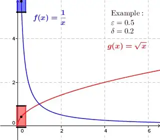

Continuity is about for each given point to find proportions of a window $$ \mathrm{height}\times \mathrm{width}=2\varepsilon\times 2\delta $$ such that the graph passes through the sides, not the top or bottom. Or to be more precise, no points on the curve lie directly above or below the window.
Pointwise: A curve is pointwise continuous, if at each point it is possible for any given height $2\varepsilon$ to adjust the width $2\delta$ so that the curve passes through the sides of the window. Again, no points must lie directly above or below.
Uniform: A curve is uniformly continuous, if it for any given height $2\varepsilon$ is possible to find a width $2\delta$ of a window that works for the entire curve.
As you can see, the blue window works only for the lower part of the curve, whereas the red window works for the entire curve. Since this will be true for any given window height $2\varepsilon$, however small the width, the blue curve is NOT uniformly continuous. For the red curve, it is always possible to adjust the width $2\delta$ (make it small enough) so that the window will work for the entire curve.
Higher dimensions: For functions $F:\mathbb R^n\to\mathbb R$ with graphs in $\mathbb R^{n+1}$ and $y=F(x)$, replace the notion of a window with the notion of a cylinder: $\mathcal B_{\delta}(x)\times(y+[-\varepsilon,\varepsilon])$. Then no points must lie "above" or "below" that cylinder, in the sense that no point with its first $n$ coordinates contained in the first ball must lie outside the interval specified in the last coordinate.
And for $G:\mathbb R^n\to\mathbb R^m$ having $y=G(x)$ use a product of balls $\mathcal B_{\delta}(x)\times\mathcal B_{\varepsilon}(y)\subseteq\mathbb R^{n+m}$. Here no points with the first $n$ coordinates contained in the first ball must have the last $m$ coordinates escaping the second ball.

  • This is a very nice explanation. +1 – Timbuc Apr 24 '15 at 12:11
  • Agree, very nice! – Nicolas Apr 24 '15 at 15:54
  • Very nice! What software? GeoGebra? +1 – Daniel W. Farlow Apr 24 '15 at 16:02
  • @MagicMan: Yes. GeoGebra is such a nice tool, I think! – String Apr 24 '15 at 16:05
  • @String Agreed! Really trying to learn more of it now, but there's just...so much to learn haha. Great use of it here for sure. Kudos my friend! Cheerio. – Daniel W. Farlow Apr 24 '15 at 16:06
  • Very Beautiful! – Ataulfo Apr 24 '15 at 16:23
  • @MagicMan: The GeoGebra-software only has a few weaknesses in it. One is that when I numerically solve differential equations, the spreadsheet crashes when adding more than a few hundred points to plot. Another is the implementation with the CAS-part, which sometimes fails. I think both has to do with algorithms designed to take care of variable dependencies and the order of the steps of calculating a given construction. That is quite complex to design, I am sure. – String Apr 24 '15 at 16:30
    This is a fantastic answer. Follow-up question: for differentiable functions, does this mean that uniform continuity is equivalent to (or implied by) a bounded derivative? It seems that if $\lvert f'(x) \rvert < M$ for some $M$, then a window proportion of $M \times 1$ should work everywhere, right? – wchargin Apr 26 '15 at 04:50
    By the way, you should add that diagram to the Wikipedia page, or release it into the public domain so that someone else can add it! (Well, all content is cc-wiki anyway, but it'd be nice to have explicit permission.) – wchargin Apr 26 '15 at 05:00
    @WChargin: Thank you for your comments+suggestions, I will certainly add it as you proposed some time soon. Regarding derivatives, the impliation you write about $|f'(x)|<M$ leading to $1\times M$ working uniformly is true. The other direction does not hold, which the example of $g(x)=\sqrt x$ shows, i.e. $1\times 2$ works uniformly for $g$, but $g'(x)\to\infty$ as $x\to 0$. – String Apr 26 '15 at 06:36
  • The window in the diagram, namely $0.4\times 1$ also works uniformly for $g$. Stating that $1\times 2$ works was just to mimic the idea of having $1\times M$ implying the derivative to be bound, which is not true. – String Apr 26 '15 at 06:50
    cool, that makes sense—thanks! – wchargin Apr 26 '15 at 14:39
  • @wchargin: I finally got around to uploading it on wikimedia commons. I have added it to the wiki-page. I looks a bit small in size right now - if anyone knows how to fix that, feel free to edit! – String Aug 11 '16 at 10:03
  • @wchargin: And I found a way to resize it. :o) – String Aug 11 '16 at 10:28
  • This is awesome. Very clear visually . – Omar Nagib Aug 31 '16 at 08:05
  • Man this answer is amazing. – codetalker Mar 09 '17 at 12:54
