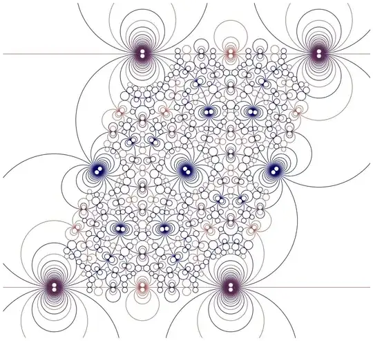

Here's an example from Stange's image gallery, taking $K=\mathbb Q(\sqrt{-7})$ and drawing all circles with curvature up to $30\sqrt 7$ that intersect the fundamental domain of $\mathcal{O}_K$:
The Schmidt Arrangement of Q(sqrt(-7))

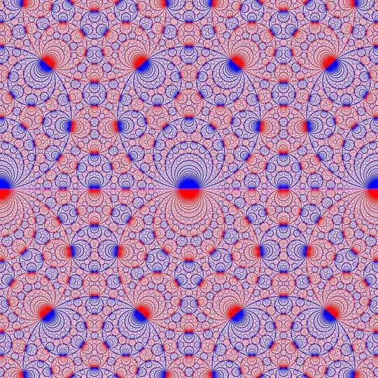

The three nested loops seem like they would blow up as $M$ becomes large, but in practice it only takes a few seconds to get up to $M=600$, which is plenty for most illustrations, like this one:

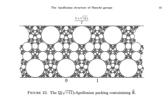

The original paper by Asmus Schmidt is interesting reading. He did not have computer so we definitely have a leg up on him. See also Stange's most recent paper The Appolonian Structure of Bianchi Groups. She includes this:
In this case we are reduced to computing coprime pairs of numbers $(a)+(b)=1$ which may or may not be easier than just finding solutions to $ad-bc=1$.
