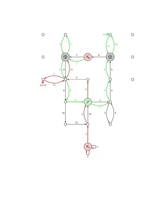

    I made a TIKZ graph of your solution: overleaf.com/2588660pvgwfg – Liz Wesley Apr 22 '15 at 03:03

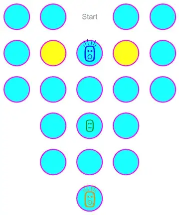

I built the game in Mathematica using the rules I think you're trying to accomplish. Here is the code if you have Mathematica:
$\hspace{3cm}$enter image description here
