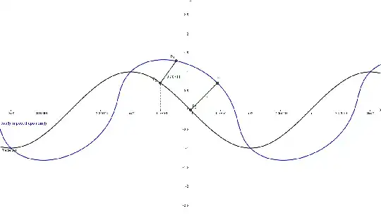

For example, this is $g(t)=cos(t)$, the imposer, imposed upon $f(t)=(t,a \cdot sin(t))$, the receiver, where $a$ is simply a real value which oscillates between $-1$ and $1$ with time. Basically, $a$ is the reason functions below are moving. a graph of cosine of t imposed upon an oscillating sine of t
The black function which resembles a standing wave, as I said before, is an oscillating sine function, and it is also the receiver. The blue function which, if you look closely, occasionally looks like a cosine function is the function resulting from imposing $g(t)$ onto $f(t)$. The green line segments are to illustrate the act of finding the point on the normal of $f(t)$ at $t$ with a distance of $g(t)$, like we covered in the above paragraphs.
