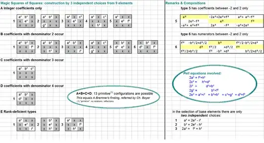

[update 3] An account of the possible 13 primitive solutions (no rotations, no reflections) on behalf of a comment of @andrewpalfreyman; this is an independent validation of A. Bremner's list:
I generated this list by computing all initial solutions and identifying the occuring coefficients. Duplicate sets of coefficients were ignored, and only $13$ distinct sets of coefficients remained. With this, the according $3 \times 3$-configurations are documented with their first occurences.
Interestingly we have sets of coefficients having only integer values, or half integer etc; my own $7$-squares solutions is here a rotation of configurations A1.
Moreover,three primitive rank-deficite initial configurations were as well identified, and I explain the reason for the rank-deficience.
  • There exist C(9,3)= 84 possible ways of expressing this reduction. I assume that some are "simpler" than others. Perhaps there's a special one that is the simplest to write down – Andrew Palfreyman Mar 18 '15 at 07:15
  • There are in fact 16 ways, following Boyer. 9,12,15 are particularly simple (9 is the one above by Gottfried Helms). 2,3,13 have no solution - which is curious. – Andrew Palfreyman Mar 19 '15 at 14:24
  • Update: just for expanding the informations in that answer, here is a link to a draft on the problem organized around my basic attempts: https://go.helms-net.de/math/divers/Helms_2022_magicSquareOfSquares2_draft.pdf – Gottfried Helms Oct 26 '22 at 12:59
  • @AndrewPalfreyman - the cases 2,3,13 are such, that the third entry is completely determined by the other two, which is if e and f are given, d is already determined and gives no new information. The same if e and a are given, i is determined. The cases 2,3 are of this form. The case 13 is "nicer": the three defining entries given form always a Pell-equation, and by this the third entry is fully determined by the two others. – Gottfried Helms Nov 09 '22 at 09:24
