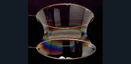

The catenary has been mentioned a number of times, but apparently not the corresponding surface of revolution, the catenoid. It and the plane are the only surfaces of revolution that have zero mean curvature (i.e. they are minimal surfaces). This surface is the form a soap bubble (approximately) takes when it is stretched across two rings:
catenoid bubble
(image from here)
