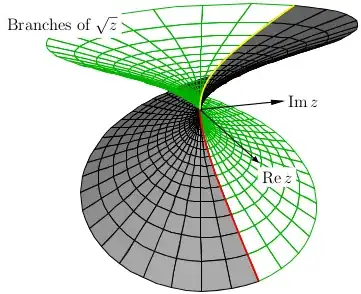

The diagram below explains why: If we start with the non-negative real square root on the non-negative real axis, then attempt to extend by continuity (the gray shaded surface), we "arrive at the negative square root" after one traversal of a circle around the origin.
Branches of the complex square root
(The entirety of the diagram, the solid gray sheet together with the green mesh, may be viewed as the real part of the "set-valued" square root described above.)
Unlike the situation for square roots of non-negative real numbers (where the "natural" domain was the set $[0, \infty)$ of non-negative reals), there is no natural domain for a continuous complex square root function. Often one removes the non-positive reals; sometimes removing the negative imaginaries (and zero) is preferable.
Further, if $\sqrt{\phantom{z}}$ denotes an arbitrary continuous branch of the complex square root, the equation "$\sqrt{ab} = \sqrt{a} \cdot \sqrt{b}$" fails to hold for some $a$ and $b$. Bother.
