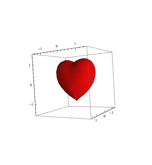

You can plot Taubin's heart surface using ContourPlot3D:
ContourPlot3D[(2 x^2 + y^2 + z^2 - 1)^3 - (1/10) x^2 z^3 - y^2 z^3 == 0,
              {x, -1.5, 1.5}, {y, -1.5, 1.5}, {z, -1.5, 1.5},
              Mesh -> None, ContourStyle -> Opacity[0.8, Red]]
Taubin's heart

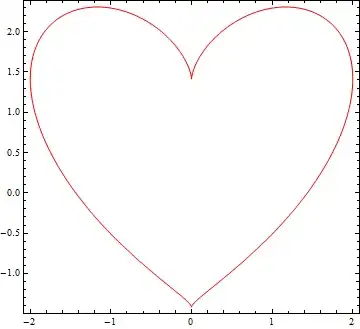

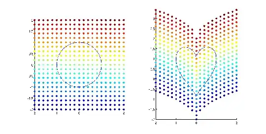

29
Consider the map $T \colon \mathbb R^2 \rightarrow \mathbb R^2, \ (x,y) \mapsto (x, y+ \sqrt{|x|})$. With a little examination, you can see that this will define a warping on the plane that will map the unit circle to a heart shaped curve: alt text
So if you know that a parametrization for the circle is $(\cos(t),\ \sin(t)),\ t\in [-\pi,\pi]$, then the parametrization for its heart-shaped image would be $(\cos(t),\ \sin(t) + \sqrt{|\cos(t)|}),\ t\in [-\pi,\pi]$. You can plot the curve with the following Mathematica code:
ParametricPlot[{Cos[t], Sin[t] + Sqrt[Abs[Cos[t]]]}, {t, -Pi, Pi}]

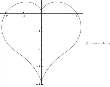

19
For the fifth function in the link you mentioned (which I thought it was the most similar to a heart):
PolarPlot[(Sin[t]Sqrt[Abs[Cos[t]]])/(Sin[t]+7/5)-2Sin[t]+2, {t, 0, 10}]
Similarly, using W|A:
alt text

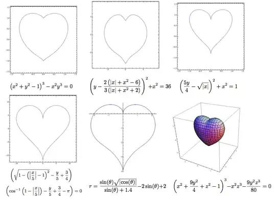

The following inputs will plot the following 6 hearts in the picture below respectively.
ContourPlot[(x^2 + y^2 - 1)^3 - x^2 y^3 == 0, {x, -1.5, 1.5}, {y, -1.5, 1.5}, MaxRecursion -> 5]
ContourPlot[x^2 + (y - (2 (x^2 + Abs[x] - 6))/(3 (x^2 + Abs[x] + 2)))^2 == 36, {x, -9, 9}, {y, -9, 9}, MaxRecursion -> 5]
ContourPlot[x^2 + (5/4 y - Sqrt[Abs[x]])^2 == 1, {x, -1.5, 1.5}, {y, -1.5, 1.5},MaxRecursion -> 5]
ContourPlot[0 == (Sqrt[1 - (Abs[x/5] - 1)^2] - y/5 + 3/4) (ArcCos[1 - Abs[x/5]] - \[Pi] - y/5 + 3/4), {x, -12, 12}, {y, -12, 12}, MaxRecursion -> 5]
PolarPlot[2 - 2 Sin[\[Theta]] + Sin[\[Theta]] Sqrt[Abs[Cos[\[Theta]]]]/(Sin[\[Theta]] + 1.4), {\[Theta], -2 \[Pi], 2 \[Pi]}, MaxRecursion -> 5]
ContourPlot3D[(x^2 + (9 y^2)/4 + z^2 - 1)^3 - x^2 z^3 - (9 y^2 z^3)/80 == 0, {x, -1.5, 1.5}, {y, -1.5, 1.5}, {z, -1.5, 1.5}]
Sample Hearts

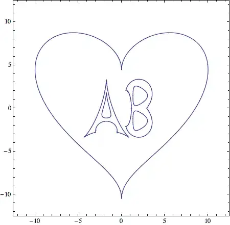

I also came up with my own strictly algebraic equation that will plot the letters AB inside of a heart for my significant other. The equation is...
$ \left(\left(\left(\left| y\right| -\frac{29}{20}\right)^2+(x-1)^2\right)^2+18 \left(\left(\left| y\right| -\frac{29}{20}\right)^2+\left(x-\frac{219}{100}\right)^2\right)-8 \left(\left(x-\frac{5}{2}\right)^3-3 \left(x-\frac{39}{20}\right) \left(\left| y\right| -\frac{147}{100}\right)^2\right)-27\right) $ $ \left(\left(\left(x+\frac{7}{4}\right)^2+\left(\frac{2 y}{3}+\frac{1}{4}\right)^2\right)^2+\frac{9}{2} \left(\left(x+\frac{7}{4}\right)^2+\left(\frac{2 y}{3}+\frac{1}{4}\right)^2\right)-4 \left(\left(\frac{2 y}{3}+\frac{1}{4}\right)^3-\left(x+\frac{7}{4}\right)^2 \left(2 y+\frac{3}{2}\right)\right)-\frac{27}{16}\right) $ $ \left(\left(\left(x+\frac{7}{4}\right)^2+\left(\frac{2 y}{3}+\frac{3}{4}\right)^2\right)^2+18 \left(\left(x+\frac{7}{4}\right)^2+\left(\frac{2 y}{3}+\frac{3}{4}\right)^2\right)-8 \left(\left(\frac{2 y}{3}+\frac{3}{4}\right)^3-\left(x+\frac{7}{4}\right)^2 \left(2 y+\frac{9}{4}\right)\right)-27\right) $ $ \sqrt{\frac{\left| \sqrt{\left(\frac{2 y}{3}+2\right)^2+\left(x+\frac{11}{4}\right)^2}+\sqrt{\left(\frac{2 y}{3}+2\right)^2+\left(x+\frac{3}{4}\right)^2}-\frac{5}{2}\right| }{\sqrt{\left(x+\frac{11}{4}\right)^2+\left(\frac{2 y}{3}+2\right)^2}+\sqrt{\left(x+\frac{3}{4}\right)^2+\left(\frac{2 y}{3}+2\right)^2}-\frac{5}{2}}} \sqrt{\frac{\left| \sqrt{(y-2)^2+\left(x-\frac{9}{20}\right)^2}+\sqrt{(y+2)^2+\left(x-\frac{9}{20}\right)^2}-\frac{21}{5}\right| }{\sqrt{\left(x-\frac{9}{20}\right)^2+(y-2)^2}+\sqrt{\left(x-\frac{9}{20}\right)^2+(y+2)^2}-\frac{21}{5}}} $ $ \left(\sqrt{\left(-x-\frac{11}{4}\right)^2+\left(\frac{2 y}{3}+\frac{7}{4}\right)^2}+\sqrt{\left(-x-\frac{3}{4}\right)^2+\left(\frac{2 y}{3}+\frac{7}{4}\right)^2}-\frac{5}{2}\right) $ $ \left(\sqrt{\left(x-\frac{1}{2}\right)^2+(y-2)^2}+\sqrt{\left(x-\frac{1}{2}\right)^2+(y+2)^2}-\frac{21}{5}\right) $ $ \left(\left((\left| y\right| +1)^2+(x-2)^2\right)^2-19 \left((\left| y\right| +1)^2-(x-2)^2\right)\right) $ $ \left(\left(-\sqrt{\left| \frac{x}{2}\right| }+\frac{3 y}{10}+\frac{9}{10}\right)^2+\frac{x^2}{20}-5\right) = 0 $
The mathematica code is...
ContourPlot[0 == (x^2/20 + ((3 y)/10 + 9/10 - Sqrt[Abs[x/2]])^2 -
 5) ((((2 y)/3 + 1/4)^2 + (x + 7/4)^2)^2 +
 9/2 (((2 y)/3 + 1/4)^2 + (x + 7/4)^2) - 27/16 -
 4 (((2 y)/3 + 1/4)^3 - (2 y + 3/2) (x + 7/4)^2)) (((x + 7/
     4)^2 + ((2 y)/3 + 3/4)^2)^2 +
 18 ((x + 7/4)^2 + ((2 y)/3 + 3/4)^2) - 27 -
 8 (((2 y)/3 + 3/4)^3 - (2 y + 9/4) (x + 7/4)^2)) (Sqrt[((2 y)/
    3 + 7/4)^2 + (-x - 11/4)^2] +
 Sqrt[((2 y)/3 + 7/4)^2 + (-x - 3/4)^2] - 5/
 2) \[Sqrt](Abs[
   Sqrt[((2 y)/3 + 2)^2 + (x + 11/4)^2] +
    Sqrt[((2 y)/3 + 2)^2 + (x + 3/4)^2] - 5/
    2]/(Sqrt[((2 y)/3 + 2)^2 + (x + 11/4)^2] +
    2)) ((((Abs[y] + 1)^2 + (x - 2)^2)^2 -
  19 ((Abs[y] + 1)^2 - (x - 2)^2))) (((x - 1)^2 + (Abs[y] - 29/
     20)^2)^2 + 18 ((x - 219/100)^2 + (Abs[y] - 29/20)^2) - 27 -
 8 ((x - 5/2)^3 - 3 (x - 39/20) (Abs[y] - 147/100)^2)) (Sqrt[(x -
    1/2)^2 + (y - 2)^2] + Sqrt[(x - 1/2)^2 + (y + 2)^2] - 21/
 5) (Sqrt[
Abs[Sqrt[(x - 9/20)^2 + (y - 2)^2] +
  Sqrt[(x - 9/20)^2 + (y + 2)^2] - 21/5]/(
Sqrt[(x - 9/20)^2 + (y - 2)^2] + Sqrt[(x - 9/20)^2 + (y + 2)^2] -
 21/5)]), {x, -12, 12}, {y, -12, 12}, MaxRecursion -> 7]
and the graph is...
AB Algebraic Heart
When using the ContourPlot function in Mathematica there are issues and you may get some noise. So your image may not be as clean as mine. Also it will take a while to plot it at MaxRecursion->7 so stand by.

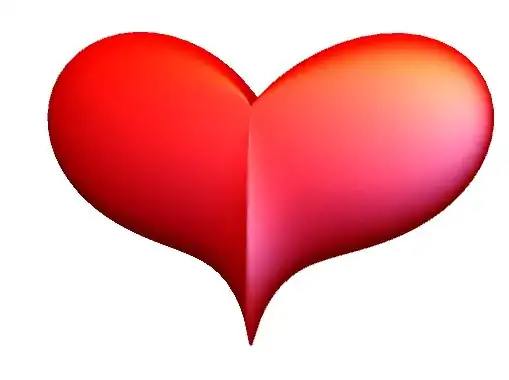

A three-dimensional space curve with the shape of a red heart:
The Mathematica code for the image above is:
ParametricPlot3D[{Cos[u]*(4*Sqrt[1 - v^2]*Sin[Abs[u]]^Abs[u]), v,
  Sin[u]*(4*Sqrt[1 - v^2]*Sin[Abs[u]]^Abs[u])},
   {u, -Pi, Pi}, {v, -1, 1}, Axes -> None, Mesh -> False,
 Boxed -> False,
   PlotStyle -> {Red, Specularity[White, 10]}]

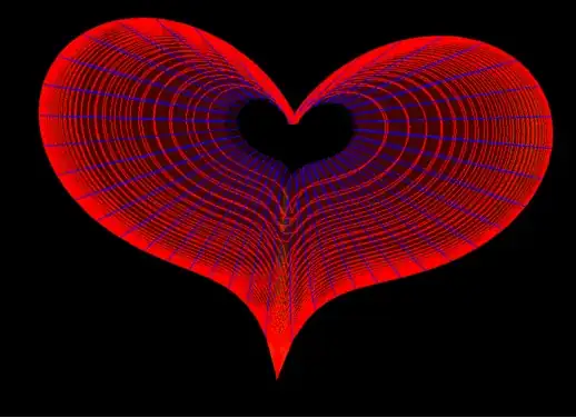

3D red heart with Mesh and lines:
Mathematica code for the image above:
  Sin[u]*(4*Sqrt[1 - v^2]*Sin[Abs[u]]^Abs[u])}, {u, -Pi,
  Pi}, {v, -0.97, 0.97}, PlotPoints -> 50, Axes -> None,
 Boxed -> False,
 PlotStyle ->
  Directive[Glow[Red], Specularity[White, 30], Opacity[0.15]],
 Mesh -> 50, Background -> Black, MeshStyle -> {Blue, Red},
 Lighting -> {{"Directional", Yellow, {{1.5, 1.5, 5}, {1.5, 1.5, 0}},
    Pi/6}}]

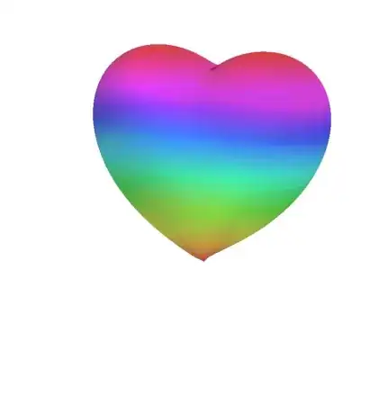

A variation on the use of the Taubin heart surface with hue:
Mathematica code for the last image above:
ContourPlot3D[(-1/10) x^2 z^3 -
   y^2 z^3 + (2 x^2 + y^2 + z^2 - 1)^3 == 0, {x, -1.2, 1.2}, {y, -1.4,
   1.4}, {z, -1.5, 1.5}, Mesh -> False, PlotPoints -> 60,
 Axes -> None, Boxed -> False,
 ContourStyle -> Directive[Opacity[0.5], Red],
 ColorFunction -> Function[{x, y, z, f}, Hue[z]]]

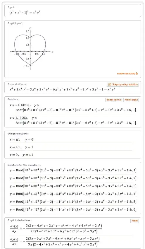

Here is a screen shot from this equation on Wolfram Alpha. I don't have a license for Mathematica.
(x^2+y^2-1)^3 = x^2
