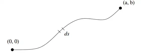

While $y'$ is a function of $y$, from the point of view of the function $f$, it only takes in a vector of real numbers and maps it to a real number. Therefore, having $x$ and $y$ as an input isn't enough. Some problems require $y'$ in the integral, e.g. let's take a simple problem, say we want to the shortest function that connects two points $a$ and $b$. Obviously the answer is a straight line, but let's do this as a variational calculus problem
We have $$ds=\sqrt{dx^2+dy^2}=dx\sqrt{1+y'^2}$$ Therefore: $$F=\int ds=\int_0^a(1+y'^2)^{1/2}dx$$
As you can see, $y'$ appears in the integral. "But wait!" I hear you exclaim, "$y'$ is just a function of $y$, so we can just say $f(y,x)=(1+y'^2)^{1/2}$ and everything is fine!"
The real point here is that $f$ does not take the whole function $y(x)$ as an input, if it did, $f$ would "know" what $y'$ was and so you could write $f(x,y)$ instead as you said. But this is not the case. $f$ takes a vector in $\mathbb{R}^3$ and gives out a scalar in $\mathbb{R}$. So for rigorous notation, you must say $f(y,y',x)$ and not $f(y,x)$.
