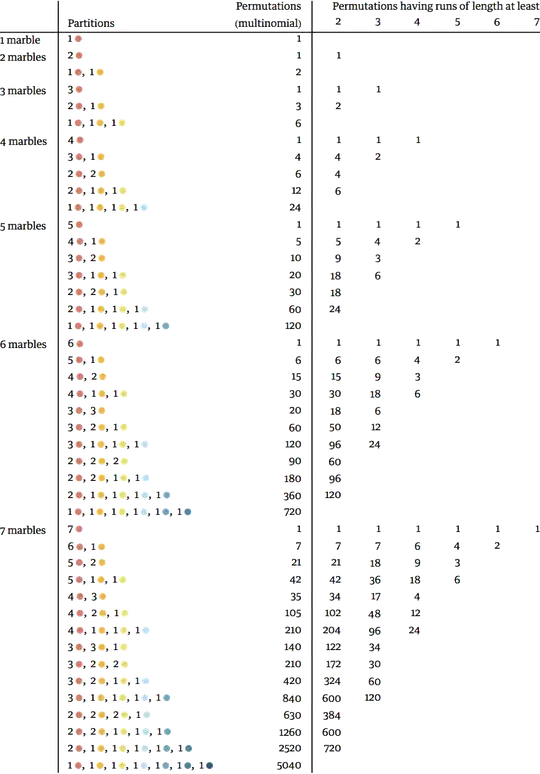

I constructed the table below, counting the permutations for configurations of up to $n=7$ marbles by brute force. The rightmost columns count the permutations having runs of length $2≤k≤n$.
Unfortunately, brute force stops being practical around $n\gtrsim 11$ (at $10^8$ permutations; see A005651).

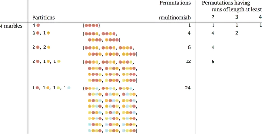

Here is a closer look at the permutations comprising the five $n=4$ cases.
I tried to find patterns along different axes that would lead me to formulas for those specific cases, which I could then generalize, but I haven’t gotten anywhere. I then tried deriving a recurrence relation, also to no avail. My hunch, however, is that there may be a Fibonacci-like recurrence relation involved.
