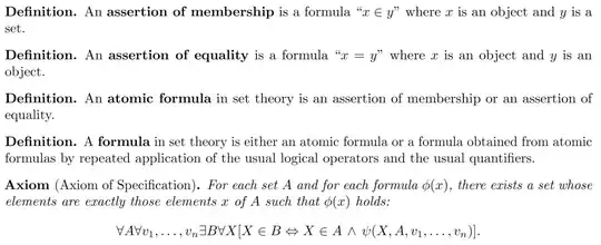

Long Answer: Restricted Comprehension vs Unrestricted Comprehension
The axiom that's closely related to the notion of classes is the "axiom of specification" which you can describe as "restricted comprehension" because it's only when we're given a set that we can apply a formula to restrict it down to the elements that satisfy the formula.
This is opposed to restricting the class of all sets "$\{x:x=x\}$" to those which satisfy a given formula "$\{ x:\phi(x) \}$"; i.e. unrestricted comprehension.
Brief review (I'm assuming you know what a general formula is in the context of first-order languages; my definition below may seem to be circular, but I don't want to have to formally define "formula" as opposed to "formula in Set Theory"):
You could describe classes by a single "meta-axiom." Keep in mind that in Set Theory the domain of discourse is the collection of all sets (i.e. the axioms only refer to sets), but by introducing this new "meta-axiom" the domain of discourse is implicitly expanded to include classes; more concretely, the quantifiers $\exists$ and $\forall$ now range over classes as well as sets (Note: you're no longer in ZFC).
Meta-Axiom Class Comprehension For each formula $\phi(x)$, there exists a class whose elements are exactly those sets $x$ such that $\phi(x)$ holds: $$\forall v_1,\ldots,v_n\exists C\forall X\Big[X \text{ is a set}\Rightarrow [X\in C\Leftrightarrow \psi(X,v_1,\ldots,v_n)]\Big].$$
