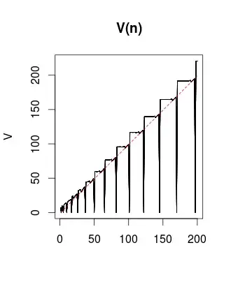

Extending @aes 's solution by simulation, my computations suggest you in fact always stay when within 6 of a perfect square, for a large enough square.
First, let's cast this as a dynamic programming problem:
$V\left(n\right)=\begin{cases} 0 & \hspace{1em}\exists k\in\mathbb{N} s.t. k^{2}=n\\ \max\left\{ n,\frac{1}{6}\sum\limits_{m=1}^{6}V\left(n+m\right)\right\} & \hspace{1em}\nexists k\in\mathbb{N} s.t. k^{2}=n \end{cases}$
That is, your value conditional on having currently the cumulative sum $n$ is given by choosing to stay (taking $n$) or averaging over future values, unless $n$ is a perfect square.
To make this computable, consider a finite version of the problem, where we force $V(n)=n$ for all $n$ past some threshold $N$; call this approximation $\tilde{V}\left(n;N\right)$.
$\tilde{V}\left(n;N\right)=\begin{cases} 0 & \hspace{1em}\exists k\in\mathbb{N} s.t k^{2}=n\\ \max\left\{ n,\frac{1}{6}\sum\limits_{m=1}^{6}\tilde{V}\left(n+m\right)\right\} & \hspace{1em}\nexists k\in\mathbb{N} s.t. k^{2}=n\cap n<N\\ n & \hspace{1em}\nexists k\in\mathbb{N} s.t. k^{2}=n\cap n\geq N \end{cases}$
I approximated this with the following code in R (slow, I know):
value_functions<-c()
NNN<-10000
squares<-cumsum(seq(1,2*ceiling(sqrt(NNN+6))-1,by=2))
for (NN in ceiling(.8*NNN):NNN){
  values<-0:(NNN+6)
  values[squares+1]<-0
  for (nn in (NN-1):0){
    values[nn+1]<-ifelse(nn %in% squares,0,
                         max(nn,sum(values[(nn+2):(nn+7)])/6))
  value_functions<-rbind(value_functions,values[0:NNN])
Here's a plot for $N=9990,\ldots,10000$, $n=1,\ldots,200$ (that we can't tell the plots for separate $N$ apart suggests convergence):
simulation
It may be hard to see, but basically what's going on is:
  1. at a perfect square, value is 0
  2. just after, we are secure for some time--and we'll roll for sure. because we know for sure that we'll roll many times, value doesn't increase (that money is guaranteed).
  3. at 6 before the next perfect square, or value plummets--now there's a risk of failure if we choose to continue.
  4. just prior to this, our value increases--we've eliminated some of the risk of failure by getting, say, 7 less than a square, which guarantees we'll be able to roll again risk-free.

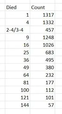

I'm not great with the maths of this so I decided to try to understand it in my own way - using Excel.
I ran a simulation of this 7776 times. Of these, 2649 games died when a 1 or 4 was rolled straight away. I assume these are of no interest to us since we don't get to make a decision to roll again.
Of the remaining 5127, 457 still failed to make it past 4. So around 8% made a mistake by even taking their 2nd roll - but they should still be included in the analysis in my opinion.
Taking the mean of all these 5127 games, we get 32.419 as the max winnings achieved before dying. This so far away from every other answer. I've been trying to see where I might have gone wrong but I can't see any flaws in my reasoning.
Here is a table of the drop-outs up to 144:
There are only 159 games still running after 144. The highest any managed to achieve was 900 - 1 game.
