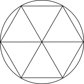

Yes, there is a quick mental picture, the inscribed hexagon:
$\hskip 1in$ enter image description here
(Or really just the top right triangle, as others have noted.)

I memorize "an equilateral triangle has equal sides and equal angles." Since I previously memorized "the angles in a triangle add up to $180^\circ$", that means it has $60^\circ$ angles. By cutting it in half I get a triangle with angles of $30^\circ$, $60^\circ$, and $90^\circ$. If I call the side length of the equilateral triangle $1$, then the right triangle has a hypotenuse of length $1$ and the side opposite the $30^\circ$ angle has length $\frac12$. I use Pythagoras (which I also have memorized) to get the third side. Um, I also need to have memorized that the size of an acute angle in a right triangle is the ratio of the opposite side to the hypotenuse.

  • Thank you, I like this answer because it is like what I did with the square. I don't even need to find the third side: I use the cosine and the two sides that I have. Thank you very much! – Anna Feb 13 '15 at 08:13
