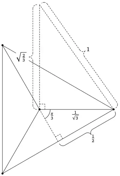

Here's a view of the geometry:
tetrahedron
and here's a view of the bottom face:
triangle
In the second diagram, the face is indicated by dashed lines, and the (isosceles) triangle formed by the center of the triangle and two of the corners is indicated by solid lines.
Knowing that the short sides of the isosceles triangle bisect the 60° angles of the equilateral triangle, we find that the angles of the isosceles triangle are 30°, 30° and 120°.
Using the law of cosines and the knowledge that the longest side of the isosceles triangle has unit length, we have the equation for the length $\ell$ of the short side (the length from the center of the bottom face to the nearest vertex):
$$1=2\ell^2-2\ell^2\cos 120^{\circ}$$
Solving for $\ell$, we find that the length from the center of the bottom face to the nearest vertex is $\frac{1}{\sqrt{3}}$, as indicated here.
From this, the Pythagorean theorem says that the height $h$ (the length from the center of the bottom face) satisfies
$$h^2+\left(\frac{1}{\sqrt{3}}\right)^2=1$$
Solving for $h$ in the above equation, we now find the height to be $\sqrt{\frac23}=\frac{\sqrt{6}}{3}$, as mentioned here.

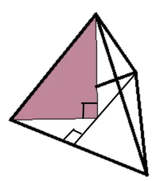

Here is an answer without words following the lines of J.M.'s answer:
robjohn
  • 353,833
