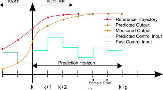

4- Why $y(t+j|t)$ is predicted in continuous form while the manipulated input is discrete? Wouldn't it be better to be continuous too? At least by connection of dots with a simple line? (see the figure below)

  4. What is continuous? MPC isalmost always defined using the discrete-time model $x_{k+1} = Ax_k + Bu_k, y_k = Cx_k + D u_k$
