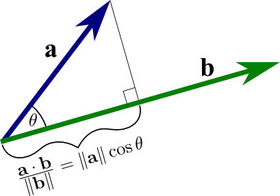

Projection
The component of a vector a that is in the same direction as of vector b (Hence projection is a vector) Length of the projection does not depend on the length(magnitude) of b. See the image below
Projection has two parts:
(i) The direction where you're projecting onto. That's the unit vector in direction of b, which is computed by dividing b by the length of b. That is $$\frac{b}{||b||}$$
(ii) The component of a in the direction of b. That is, the "shadow" or image of a when you project it onto b. This is computed by $$\frac{a⋅b}{||b||}$$ . because a⋅b=||a|| ||b|| cos(θ). Hence
||a||cos(θ)= $\frac{a⋅b}{||b||}$
and that gives you (as in the triangle figure), the length of a's projection on the direction of b
Putting it together, the projection of a onto b is a vector of length $$\frac{a⋅b}{||b||}$$
in the direction of $\frac{b}{||b||}$, i.e. $$\frac{a.b}{||b||} \frac{b}{||b||} $$
