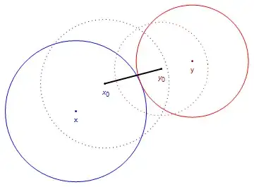

In my experience, there are five properties of $\mathbb{R}^n$ (off the top of my head) that could potentially foul up your reasoning because they don't hold for arbitrary metric spaces.
  • $\mathbb{R}^n$ is second-countable.
  • The closure of $\{y\in\mathbb{R}^n: d(x_0,y)<r\}$ coincides with the set $\{y\in\mathbb{R}^n: d(x_0,y)\leq r\}$.
  • The set $\{y\in\mathbb{R}^n: d(x_0,y)\leq r\}$ is compact.
  • If you have a sequence $\{B_n\}$ of closed balls such that $B_{n+1}\subseteq B_n$. Then the intersection $\bigcap B_n$ is non-empty; i.e. $\mathbb{R}^n$ is spherically complete.
  • $\mathbb{R}^n$ does not have "local groups" or "sets of points which are equally easy to get to from another fixed point". By this I mean that if you have two distinct points $x$ and $y$ from $\mathbb{R}^n$ and you have another point $y_2$ which is "close to $y$ in comparison to $x$" then it still might be possible that it is strictly easier to get to $y_2$ from $x$ than it is get to $y$ from $x$.
The first property sort of says that $\mathbb{R}^n$ isn't very "wide". The second property says that points which are $r$ units away from some fixed point are still close to points which are less than $r$ units away from that same fixed point. The third property sort of intimates that $\mathbb{R}^n$ doesn't have "very many dimensions". The fourth property says that if you give somebody a countable set of narrower and narrower commands (but not necessarily a set of commands that uniquely identify one course of action), they'll be able to satisfy the entire set of your commands. I'll expand on the fifth property with ultrametric spaces.
