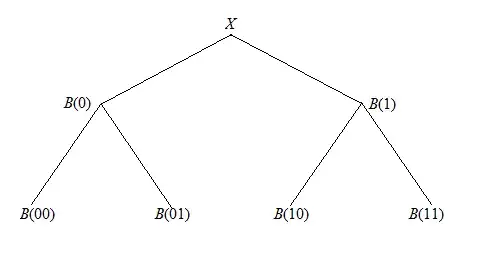

This is an ultrametric, and the space is homeomorphic to the familiar middle-thirds Cantor set. If $p_0$ and $p_1$ are the sequence of all zeros and the sequence of all ones, respectively, then $\mathscr{B}_0=\{B(p_0,1),B(p_1,1)\}$; $B(p_0,1)$ contains every sequence whose first term is $0$, and $B(p_1,1)$ contains every sequence whose first term is $1$. For simplicity let me call these two sets simply $B(0)$ and $B(1)$, respectively. Now let $B(00)$ be the set of all sequences that begin with $\langle 0,0\rangle$, $B(01)$ the set of all sequences that begin with $\langle 0,1\rangle$, and so on. Then it’s not hard to check that $\mathscr{B}_1=\{B(00),B(01),B(10),B(11)\}$, where $B(00)$ and $B(01)$ partition $B(0)$, and $B(10)$ and $B(11)$ partition $B(1)$. So far, then, we have the following tree of sets:
This particular tree base happens to be binary: each set splits in two at the next level. (And if this reminds you of the usual construction of the Cantor set, that’s good: it should.)
