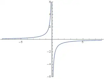

Here is a graph of the function $y=-1/x$:

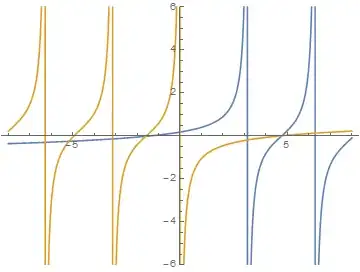

If we add infinitely many similar functions with a shift of $\pi/2$ each in both directions, we get $\tan x$. But if we do the same only in one direction, we get "incomplete tangent":
http://storage7.static.itmages.ru/i/14/0910/h_1410326921_7988832_91f3fd7d7d.png
The yellow one is $\operatorname{pg}(x)=\frac 1\pi \psi (\frac x\pi)$, the blue one is $\operatorname{cpg}(x)=-\frac 1\pi \psi (1-\frac x\pi)$. They obey $\operatorname{cpg}(x)+\operatorname{pg}(x)=-\cot(x)$.

  • I don't see what $\tan(x)$ or these other two functions have to do with $1/x$. – 2'5 9'2 Nov 19 '14 at 06:42
  • @alex.jordan: There is a formula expressing the $($co$)$tangent function in terms of digamma functions; there is another formula, expressing digamma functions in terms of harmonic numbers; and then there's yet another formula, expressing harmonic numbers in terms of $\dfrac1x$. This graphic seems to be a geometric and very visually intuitive embodiment of the afore-mentioned algebraic formulas. – Lucian Nov 19 '14 at 07:18

  • I still don't see how the "blue" and "yellow" curves are defined. If you only sum $\sum\frac{1}{x+n\pi}$ in one direction, then for any $x$ all but finitely many terms are of the same sign, and grow harmonically, giving a divergent series. – 2'5 9'2 Nov 19 '14 at 08:35
  • @alex.jordan: Using either Desmos, or GeoGebra, or some other software of your choosing, plot $\dfrac1x$ and $\dfrac1{x\pm1}$, as well as their sum, onto the same graphic. Notice the similarity with the $($co$)$tangent's graph. Continue adding symmetrical pairs of the form $\dfrac1{x\pm n}$, and plotting their sum. Notice what happens. Then plot $\cot(\pi x)$ onto the same graphic. – Lucian Nov 19 '14 at 09:16
    @Lucian I get that; what I don't get is what OP means by "if we do the same only in one direction". $\sum_{n\geq n_0}\frac{1}{x+n}$ is divergent. So is $\sum_{n\leq n_0}\frac{1}{x+n}$. – 2'5 9'2 Nov 19 '14 at 13:58
