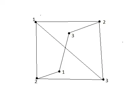

There are 3-colorable graphs with $K_4$ as a minor.
For instance:
So your assumption about necessity is incorrect. The sufficiency is true (and not a conjecture).
(Also, there is really no need to bring 3SAT into the picture, 3-colorability (of loopless graphs) is 'classically' known to be NP-Hard).

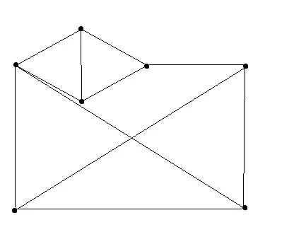

For a graph with no $K_4$ (as subgraph) which requires $4$-colours:

    Ok, seems like I conflated subgraph and minor. – Tim Seguine Jan 23 '12 at 09:43
  • Just as a help, can you give an example of a graph that requires four colors that doesn't contain $K_4$? – Tim Seguine Jan 23 '12 at 09:56
  • @Tim: If it does not contain $K_4$ as a minor, then it is 3-colorable (the sufficiency part). So that is not possible. – Aryabhata Jan 23 '12 at 10:05
  • No, sorry, I think you misunderstood my question, I wasn't asking about graphs that don't contain it as a minor. I was asking about graphs that don't contain it as an isomorphic copy. – Tim Seguine Jan 23 '12 at 10:09
    @TIm: I see. Apologies. See the edited answer for a figure. The idea was to replace one of the edges of $K_4$ with a gadget which behaves like an edge, when using only 3 colours. – Aryabhata Jan 23 '12 at 10:19
  • Ok, well there seems to be a little bit of a problem. Me mixing up terminology and whatnot. The statement about minors is clear now (Thanks again). The result I had (in my head at least) meant to quote is that the graph is three colorable iff no series of edge contractions results in $K_4$ (I think this is true). Is there an equivalent result about the fixed parameter tractability of the subgraph homeomorphism problem(I think this is the right one)? – Tim Seguine Jan 23 '12 at 13:20
  • @Tim: Doesn't the above counterexample work for you new hypothesis too? – Aryabhata Jan 23 '12 at 17:45
  • Yes, exactly, it does. Sorry. – Tim Seguine Jan 24 '12 at 08:21
