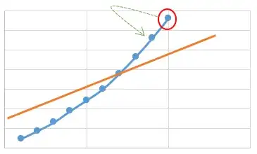

Interaction effect means the target is dependent on the interaction of two features i.e. X,Y but the data doesn't consider that Feature i.e. XY.
Simple model which tries to find a global pattern with the dataset will suffer from this issue e.g. LinearRegression.
Interaction Effect needs a full chapter for itself. Read here
Let's check this plot where the target is dependent on (X, Y, XY). For simplicity, I have kept the plot 2-D (ignoring Y).
We can easily observe that LinearRegression will have more challenges to predict the circled point.
While KNN will better approximate since it is not dependent on global pattern and will look on nearby data.
$\hspace{3cm}$enter image description here
In other words, the Interaction effect doesn't look prominent in a small portion of the space while it can have a large impact if we see the whole dataset together.
KNN works only with a small portion of space at a time(assuming small K).
