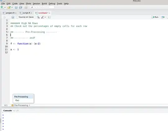

RStudio automatically recognizes headers in an R script that are set via comments:
I would like to exploit that feature, but I don't quite understand what the rules are for RStudio to recognize them as headers. Can someone explain?

Check out Code Folding and Sections:
Code sections allow you to break a larger source file into a set of discrete regions for easy navigation between them. Code sections are automatically foldable—for example, the following source file has three sections (one expanded and the other two folded):
To insert a new code section you can use the Code -> Insert Section command. Alternatively, any comment line which includes at least four trailing dashes (-), equal signs (=), or pound signs (#) automatically creates a code section. For example, all of the following lines create code sections:
# Section One ---------------------------------
# Section Two =================================
### Section Three #############################
Note that as illustrated above the line can start with any number of pound signs (#) so long as it ends with four or more -, =, or # characters.
(highlights by myself)
