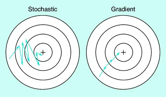

Gradient Descent should have better results as it runs in your whole data. Stochastic Gradient Descent looks at batches, making it useful for big data. Batches( or subset) make it run faster but, it can get converge at a local minimum.
On Wikipedia you can find the following citation :
SGD replaces the actual gradient (calculated from the entire data set) by an estimate thereof (calculated from a randomly selected subset of the data). Especially in high-dimensional optimization problems, this reduces the computational burden, achieving faster iterations in trade for a lower convergence rate
SGD vs GD
