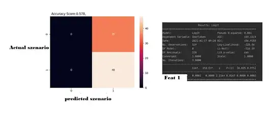

so I'am doing a logistic regression with statsmodels and sklearn. My result confuses me a bit. I used a feature selection algorithm in my previous step, which tells me to only use feature1 for my regression.
The results are the following:
So the model predicts everything with a 1 and my P-value is < 0.05 which means its a pretty good indicator to me. But the accuracy score is < 0.6 what means it doesn't say anything basically.
Can you give me a hint how to interpret this? It's my first data science project with difficult data.
My code:
X = df_n_4["feat1"]
y = df_n_4['Survival']
use train/test split with different random_state values
we can change the random_state values that changes the accuracy scores
the scores change a lot, this is why testing scores is a high-variance estimate
X_train, X_test, y_train, y_test = train_test_split(X, y, test_size=0.2, random_state=2) print(len(y_train)," Testdaten")
check classification scores of logistic regression
logit_model = sm.Logit(y_train, X_train).fit() y_pred = logit_model.predict(X_test) print('Train/Test split results:') plt.title('Accuracy Score:{}, Variablen: feat1'.format(round((accuracy_score(y_test, y_pred.round())),3))) cf_matrix = confusion_matrix(y_test, y_pred.round()) sns.heatmap(cf_matrix, annot=True) plt.ylabel('Actual Szenario'); plt.xlabel('Predicted Szenario'); plt.show() print(logit_model.summary2())

Something's wrong with your feature selection tool: p-value is NaN, confidence interval includes $0$. Confusion matrix shows that all observations are predicted as Class 1. How many explanatory variables do you have? Try using all of them instead of just one. Are you sure
is correct? Shouldn't it be the other way around, logit_model = sm.Logit(X_train, y_train).fit()?

To summarize from the comments:
  1. statsmodels doesn't automatically add an intercept.
  2. Use the predicted probabilities, not just the hard classification (that you've obtained by rounding the predictions).
It doesn't seem to me that anything is seriously wrong with the model, though perhaps it's not a particularly great model. I would try some models with more of the features; you haven't said anything about the feature selection method, and feature selection is hard.
