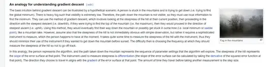

Just focusing on "sign" part. The sign of the gradient tells in which direction to move but only "locally". Once you move you have a new surface and then may be now the steepest portion(which leads to global minima/maxima) is not there and then you need to decide again the direction based on the sign and this might not be optimal.
As Wikipedia https://en.wikipedia.org/wiki/Gradient_descent gives an example. Imagine you are on a top of mountain and everything is foggy and you want to get to the bottom. You calculate and take the step in the steepest direction which you think will lead to the bottom but since there is fog your visibility is limited, this step might land you in the position from there next step is NOT getting to the bottom.
As the above answer also suggests this will lead to slow convergence as well.
