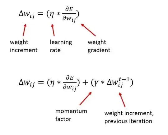

Maths
The momentum factor is a coefficient that is applied to an extra term in the weights update: Momentum
Note: image from visual studio magazine post

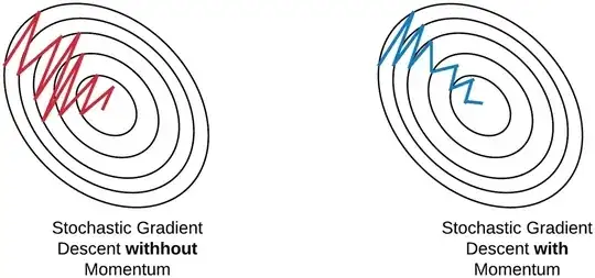

Momentum is a technique to prevent sensitive movement. When the gradient gets computed every iteration, it can have totally different direction and the steps make a zigzag path, which makes training very slow. Something like this.
To prevent this from happening, momentum kind of stabilizes this movement. You can find more in the Following Article
