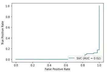

One potential fix is to remove max_iter = 12 (which would set it to the scikit learn default of max_iter=-1). Using such a low value can lead to bad scores as you can see from the following example:
from sklearn.model_selection import train_test_split
from sklearn.svm import SVC
from sklearn.metrics import plot_roc_curve
from sklearn.datasets import load_breast_cancer
data = load_breast_cancer() X_train, X_test, y_train, y_test = train_test_split(data.data, data.target, test_size=0.2)
model = SVC(max_iter=12, probability = True) model.fit(X_train, y_train)
plot_roc_curve(model, X_test, y_test)
results in
ROC with max_iter=12
However, executing exactly the same code (max_iter=12 still) again gives a totally different result:

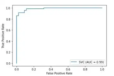

ROC max_iter=12
After removing max_iter=12 the code consistently produces higher AUCs around $0.95$ to $0.99$.
