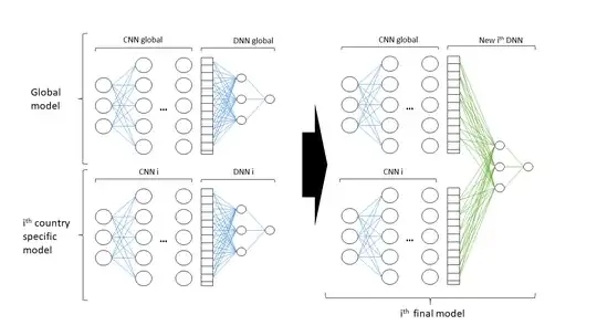

  • A specific example using NNs: train a global model and one model per country. Then use per country a model that combines both the global and the specific you trained before and only retrain the 'head'. For instance if using DNNs / CNNs, you only retrain the green part of the final model: gloabl-local_NN_combination
