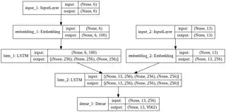

I noticed that in all these examples the structure of the neural network is not done by using a Sequential structure with consecutive layers, but rather a more complex structure like this:
Question: are there successful attempts of doing sentence language translation with classic Sequential layers?

If you ask me, I would say the following code (taken from link) is the simplest model structure possible using a simple LSTM/seq2seq model.

From your question, it seems you only want to define the model using only Keras's sequential layer. If that is the case then you must know that variable encoder_states plays an important role in the aforementioned model's definition.
LSTMs are sequential models which means it works on a single word at a time and calculates hidden state for the next word in one iteration. The process is followed for all words in the input sequence (source language). Then the final hidden state is used in the decoder layer to compute the context for output sequence (destination language). That's why there is initial_state=encoder_states in decoder LSTM layer definition. Without encoder_states decoder LSTM won't know the context and your model will only give jibberish output.
Sadly the answer is No.
You can only try to understand how machine translation works and get comfortable with the complexity of the machine translation model definition. As this is the simplest model possible.

The reason why the seq2seq models are not just stacks of layers is that the decoder cannot know in advance how long the output will be (at the inference time) and the next actions of the decoder depend on its previous actions. This property of the decoder is called autoregressivity. The decoder needs to keep track of two things: what is on the input (left branch of your diagram) and it did in the previous steps (right branch of the diagram).
Formulating MT as a stack of layers is an active research area, mostly because it offers a significant speedup, but usually at the expense of translation quality. This approach also does not work with LSTMs, but only with Transformers because the self-attentive layers in the Transformer directly allow arbitrary reordering of input states which is a crucial feature for MT because different languages have different word order.
