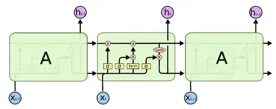

Simple explanation with images
We know that an activation is required between matrix multiplications to afford a neural network the ability to model non-linear processes.

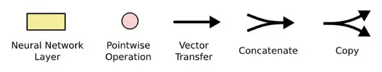

A classical LSTM cell already contains quite a few non-linearities: three sigmoid functions and one hyperbolic tangent (tanh) function, here shown in a sequential chain of repeating (unrolled) recurrent LSTM cells:
Sequential (unrolled) LSTM cells Symbol legend Images borrowed from "colah's blog"
So far this is just a single LSTM layer, and here we see that the cell output is already the multiplication of two activations (a sigmoid and a hyperbolic tangent). In this case, you could agree there is no need to add another activation layer after the LSTM cell.
You are talking about stacked layers, and if we put an activation between the hidden output of one layer to the input of the stacked layer. Looking at the central cell in the image above, it would mean a layer between the purple ($h_{t}$) and the stacked layer's blue $X_{t}$. You will notice then, that the output in this case, like with the sequential output, has already been activated, as it is the exact same output as the black left-to-right arrow (know as $f_{t}$). What is more, the first thing the input would do in the stacked layer is to be passed through the sigmoids and hypoerbolic tangents of the forget/input/output gates.
So there are plenty of non-linearities being used, meaning it is unnecessary to add yet another between the stacked LSTM layers. You might like to think of it as simply applying two ReLU layers after a fully-connected layer. The results might be slightly different compared to just using one, but not much; as in your experiements with stacked LSTMs.
