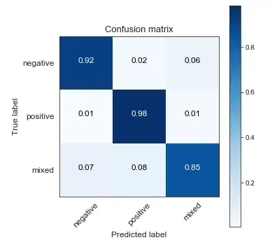

When I train on the uncorrected labels and then predict the test set I get:
Corrected Test Set - Model trained uncorrected

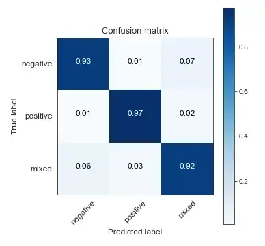

When I train on the corrected labels for the corrected test set I get:
Corrected Test Set - Model trained corrected
Likewise, the model trained on the uncorrected data performs better on the original uncorrected test set than the model trained with the corrected data. Somehow removing only incorrect labels with high confidence from the train set appears to decrease performance on unseen data. I would probably have to remove all incorrect labels and not only those identified through high confidence.
