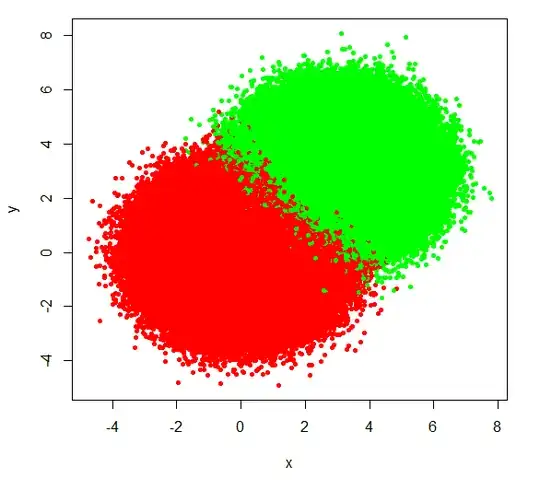

plot(x,y, pch=20, col=rainbow(3)[z])
Initial plot

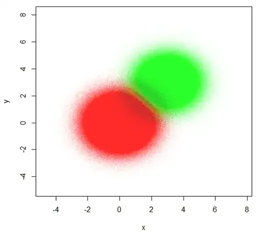

The base plot without any adjustments is not very nice. Let's apply suggestions 1 and 2.
plot(x,y, pch=20, cex=0.4, col=rainbow(3, alpha=0.01)[z])
Reduced point size and high transparency
Reducing the point size and making the points highly transparent helps some. This gives a better idea of the overlap between the two distributions.

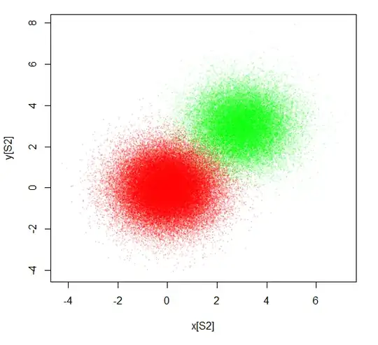

## The purpose of S2 is to downsample the data
S2 = sample(3000000, 100000)
plot(x[S2],y[S2], pch=20, cex=0.4, col=rainbow(3, alpha=0.1)[z[S2]])
Downsampled data
This gives a different view that provides a similar, but not identical understanding of the two distributions.
These are not magic, but I think that they are helpful.
