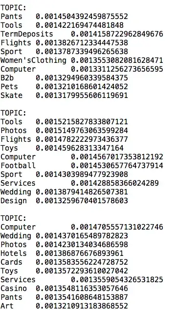

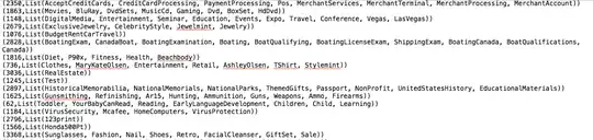

I am currently selecting features of products by using LDA to group 6000 keywords of product into topics. Here is the sample of my dataset after being organized into list of keywords for each product id. enter image description here I consider each id as a "document" and each keywords as the "word" in a "document" for the case of LDA. It didn't work out as I expected as each topic have many identical keywords with different weight. I removed 100 most common keywords but there are still some identical keywords in the topics. Here is the sample output: enter image description here
How can I deal with the identical keywords in my topics? and also how to deal with the 100 most common keywords I removed?

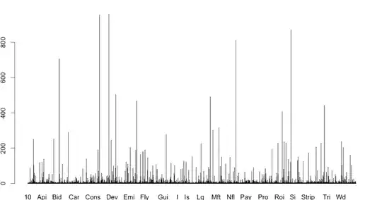

Here is the graph showing the frequency of the words in all "documents" enter image description here Each word only presents once in each document, but may present in different documents. I updated a new graph of the frequency of the words

I experimented with LDA topic modeling for recommendation systems purposes. I've few runs for offers in our marketplace service. It is in some aspect similar to Your problem with products and a list of keywords. But in our case, we do not have a product definition and an offer description is created by a seller. So You can imagine what tokens soup You will get :-)
The key point for me wast to analyze TF, IDF and TFIDF inside categories where I've tested LDA. E.g. for Toys category (http://allegro.pl/zabawki-11818?ref=simplified-category-tree) ~ .5M items, LDA based only on its names results in:
TOPIC:
lego    0.02282500803373657
puzzle  0.016679246682968853
gra     0.01092812347216676
klocki  0.010650330607355207
trefl   0.006797740719581059
zabawka 0.006365688767908592
lalka   0.0063546887775893105
maskotka        0.006111593588558912

And the rest looks almost the same. Before running LDA I just did basic text preprocessing - our dictionary based item-name stop words removal and text tokenization (but without steaming). Even giving more terms for topic descriptions results doesn't look promising. Then, after exporting word frequencies with its offer categories by looking at data and plots I've decided to remove terms with TF-IDF above some threshold. Yes, above - I've used the calculation provided by Spark 1.3.1 implementation (HasingTF + IDF from mllib, no ml). After doing this I received:

I think, even before doing LDA, you should remove words which appear in more than "x" percent of your documents. Try different "x" starting from 80% and then going down. The logic is that if the word is common for many documents, it does not distinguished those and should be neglected.

You may encounter this problem of identical keywords when the index of the documents in the corpus is wrong, i.e. the list of occurrences vector has bad document ids (for instance the same document id for all documents):
<id_doc_0>, <vector of occurrences for doc 0>
<id_doc_1>, <vector of occurrences for doc 1>
