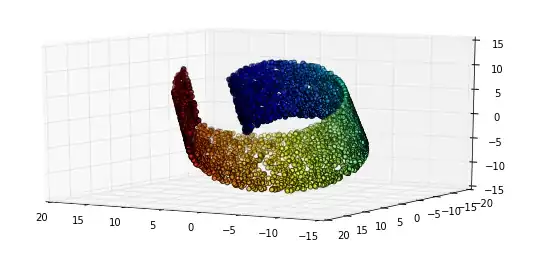

To answer this question, consider another example of a manifold:
This is so-called "swiss roll". The data points are in 3d, but they all lie on 2d manifold, so the dimensionality of the manifold is 2, while the dimensionality of the input space is 3.

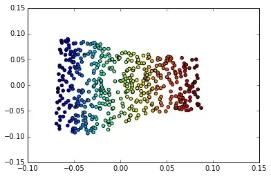

There are many techniques to "unwrap" these manifolds. One of them is called Locally Linear Embedding, and this is how it would do that:
Here's a scikit-learn snippet for doing that:
from sklearn.manifold import LocallyLinearEmbedding
lle = LocallyLinearEmbedding(n_neighbors=k, n_components=2)
X_lle = lle.fit_transform(data)
plt.scatter(X_lle[:, 0], X_lle[:, 1], c=color)
plt.show()
