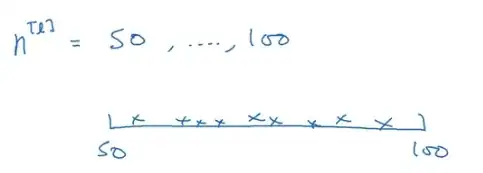

To understand this, consider the number of hidden units hyperparameter. The range we are interested in is from 50 to 100. We can use a grid which contains values between 50 and 100 and use that to find the best value: enter image description here

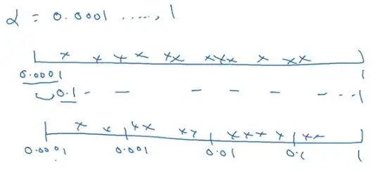

Now consider the learning rate with a range between 0.0001 and 1. If we draw a number line with these extreme values and sample the values uniformly at random, around 90% of the values will fall between 0.1 to 1. In other words, we are using 90% resources to search between 0.1 to 1, and only 10% to search between 0.0001 to 0.1. This does not look correct! Instead, we can use a log scale to choose the values:

Let us assume you want to do hyperparameteroptimization with a hyperparameter $h\in[0,1]$. Let us additionally assume that we want to test hundred possible values for the parameter.
If you choose a linear scale your parameter values will be uniformly selected form $[0,10^4]$. It will be very unlikely that you will small parameter values smaller than $10^{-4}$, because it is very unlikely to choose a number from this interval. The probability for randomly choosing a number from this interval is given by the following fraction
$$\dfrac{10^{-4}}{10^4}=10^{-8}.$$
Now if we choose our random numbers from the intervall $[-5,5]$ and use this as the power of the number $10$ we will stretch the interval onto an exponential scale which will make it more likely that we have numbers in $[0,10^{-4}]$ because the chance of choosing a negative number for the exponent is much more likely. The probability will be $1/10$, because the wanted interval from $[-5,-4]$ has a width of $1$ and the whole interval from $[-5,5]$ has the width $10$.
