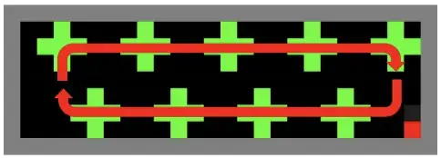

Based on DeepMind publication, I've recreated the environment and I am trying to make the DQN find and converge to an optimal policy. The task of an agent is to learn how to sustainably collect apples (objects), with the regrowth of the apples depending on its spatial configuration (the more apples around, the higher the regrowth). So in short: the agent has to find how to collect as many apples as he can (for collecting an apple he gets a reward of +1), while simultaneously allowing them to regrow, which maximizes his reward (if he depletes the resource too quickly, he looses future reward). The grid-game is visible on the picture below, where the player is a red square, his direction grey, and apple green: enter image description here As given in the publication, I've built a DQN to solve the game. However, regardless of playing with learning rate, loss, exploration rate and its decay, batch size, optimizer, replay buffer, increasing the NN size the DQN does not find an optimal policy pictured below: enter image description here I wonder if there is some mistake in my DQN code (with the similar implementation I've managed to solve OpenAI Gym CartPole task.) Pasting my code below:

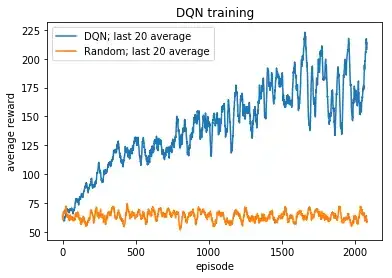

EDIT: Added the reward graph (below).
macwiatrak
  • 41
You say that the agent can achieve high results so it appears to be learning something but it fails to do this consistently. Is there are significant drop off in performance at some points?
Is there no improvement in the results if you use Adam instead of RMSProp? I'd be surprised if this was a "difficult" environment that needed a lot of tweaking. I'm curious as to what your reward graph looks like when compared to just "random" behaviour which I think would also survive in this environment.
